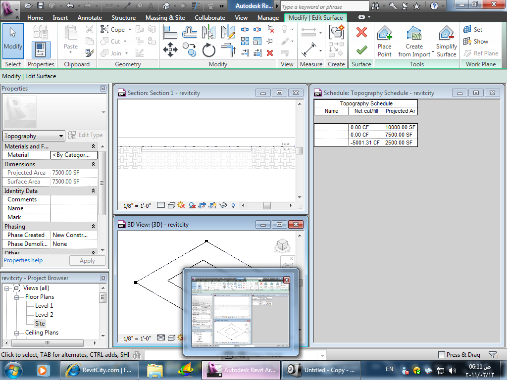

let's have a simple cut\fill example
toposurface 100*100 feets
building pad 50*50 feets  with 1 feet thickness and 1 feet depth
the claculaion should be
50*50*2= 5000 cf  piece of cake
but the result in revit is 5001.31
and i did another one using metric units and the get up to 5% less than the right result
am i doning someting wrong
