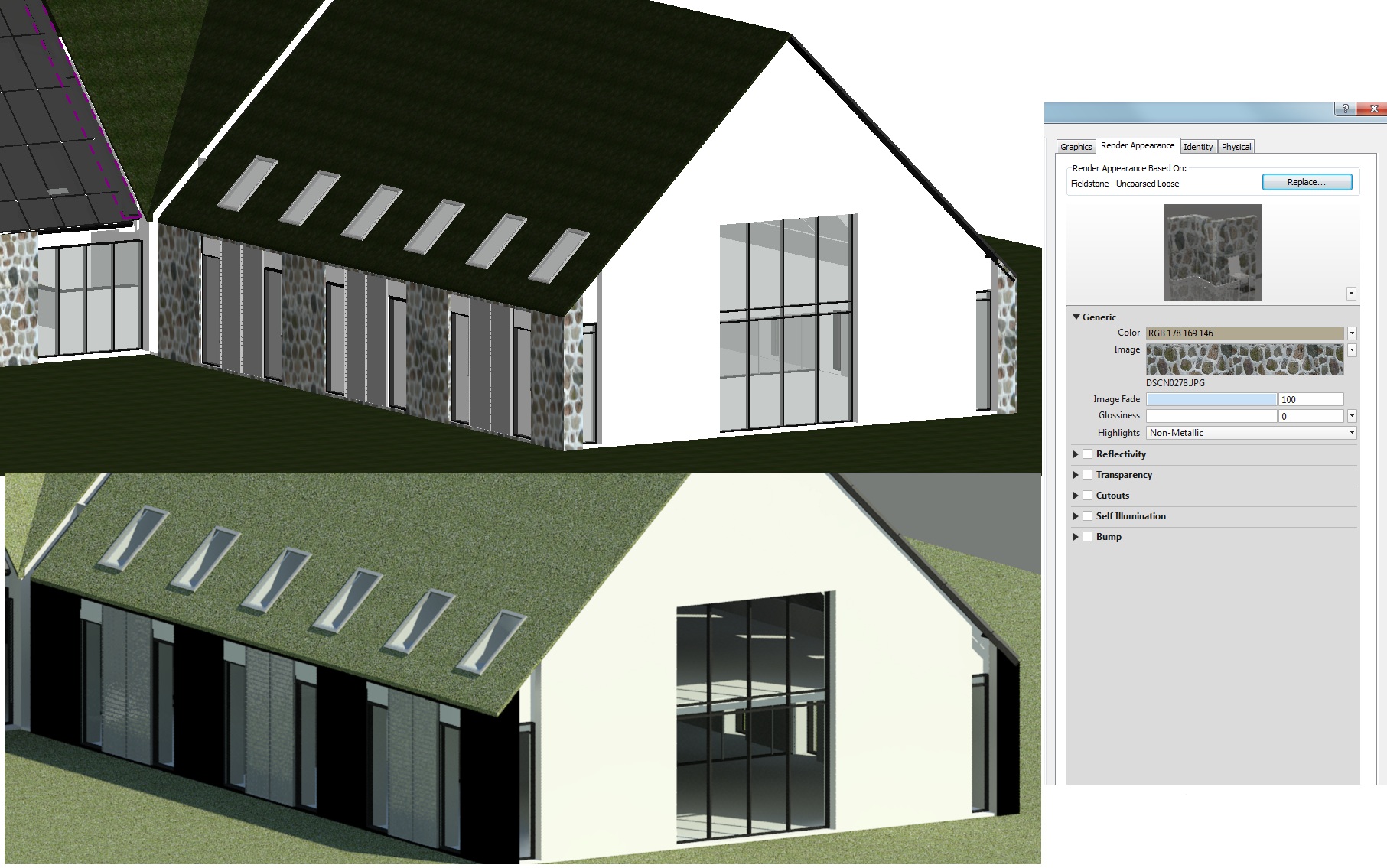

I've searched and searched and haven't found anything that seemed like a solution for our very weird error. Please see the attached image.
 To the right you see my Material settings, and you see that the preview looks good. On the upper picture you see the building in in "Realistic" view mode, and it look alright.
Although, on the bottom picture, you see it when it's been rendered. WHY does it turn black? Anyone have any idea?
 Do one have to modify the picture in any way? Remove some kind of file protection or whatever? It's a Jpeg of a camera slightly cut into right size, and it won't work. I've tried downloading other pictures of the internet and used them, and that worked well.
 We've even sent the file and picture to another Revit user who tried and got it to work, so why in the hell won't it work for us?
I've run out of ideas. Please help.
EDIT: SOLVED! After some hours of trixing, It's finally solved. I had tried resaving it in  "Microsoft Office Picture Manager". No luck. Resaving in "Photoshop", no luck. So finally I now resaved it in "Microsoft Paint" and it finally FUCKING worked.
