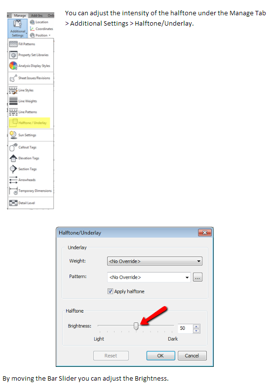

I changed the settings under manage tab>additional settings>halftone/underlay options
this solved my problem across the board so no need to adjust each view.
Wed, Apr 30, 2014 at 2:15:48 PM | Linked file - Cannot remove halftoning
#9
That is only how much your halftone is.  FOR ALL HALFTONE IN THE PROJECT!
That doesn't explain why your linked files are halftone in the first place.
But if your happy with this, we're done.

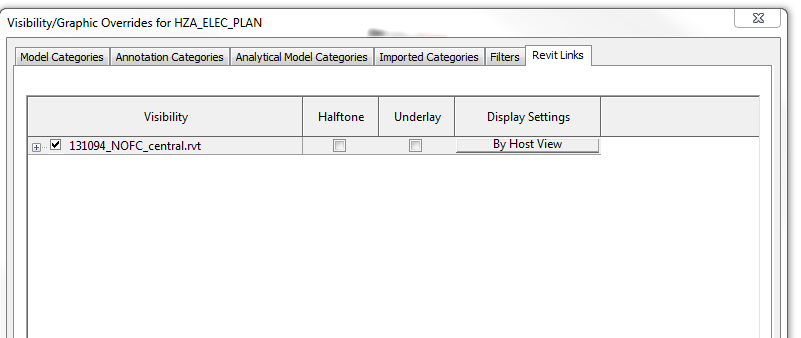

Maybe you didn't understand everything.  Show us a screen capture of your VG settings with the revit links tab picked.
Are you using phases?  If so, then show us the properties for the linked file in your view.

I'm not using phasing in this project.
Here's the screenshot - this option doesn't seem to change the way the model is showing.

Click on the linked file in a view - right click and pick over-ride graphics in view - by category.  If it is like the attached then this is your problem.
Now if that isn't it,you didn't show us the properties for the linked file in that view.   I want to see what phase the linked file is in.
