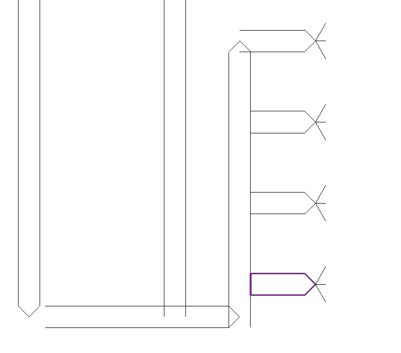

I'm trying to make a detail component consisting of 2 lines that will clean up if it intersects. Maybe I've missed something, but I can't seem to figure this out. I guess I'm looking for something like a wall tool without any 3d stuff. Any ideas?

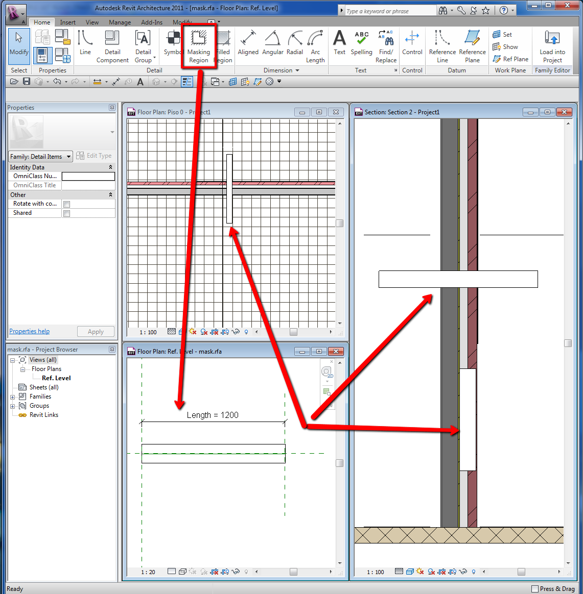

If I have understood your question, did you use the "Metric/Imperial Detail Component line based" and create a "Mask region"?

I used the Impereial "Detail Component line based.rft". Not using a masking region (yet). I'm just trying to find a way to clean up a double line with arrowhead. I would like the component to detect when it intersects and clean up or join. If a Detail Component isn't the correct way to do it, tell me if there is a way.
 I thought about adding a couple styles of masking region with visibilty checkboxes for different joins.

I ended up using three masking regions with visibility and it works, I just wish I could find a way to make it work like a wall clean-up.
