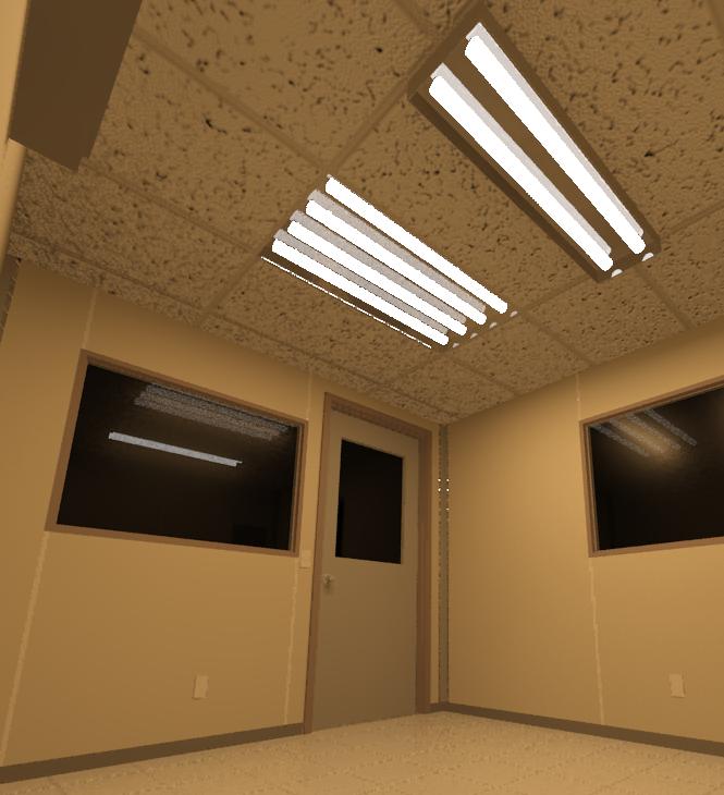

I've created a flourescent light family which can be switched between surface mounted and recessed with only a click of YES/NO parameter. I have an opening in the ceiling that I'd like to eliminate or hide when the light is surface mounted. It's not a big deal but if I just leave the opening, then ceiling grid lines are removed (obviously) in reflected ceilings plans. I suppose I could just eliminate the opening from the family and create cutouts in the ceiling profile but that just seems inefficient.
Can anybody give me some advice? Thanks.

This may work for what you are doing: http://www.revitcity.com/forums.php?action=viewthread&thread_id=18635

Oh fantastic, I am very familiar with this technique but never even thought of using a void to cut my host element. I thought I had to use the "Opening" tool for hosts. Thanks alot WW!
