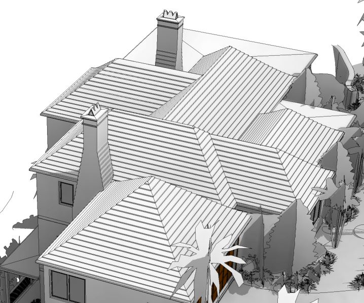

Hi Virtu,I am from Bermuda and am trying to create a real Bermudian roof - with the kick (or edge flare) at the base. I've done every method of textures and bump maps to make roofs look reasonable, but would like to know if you managed to make a parametric roof or something that actually represents a physical Bermuda roof (wall sweeps have got me the closest).

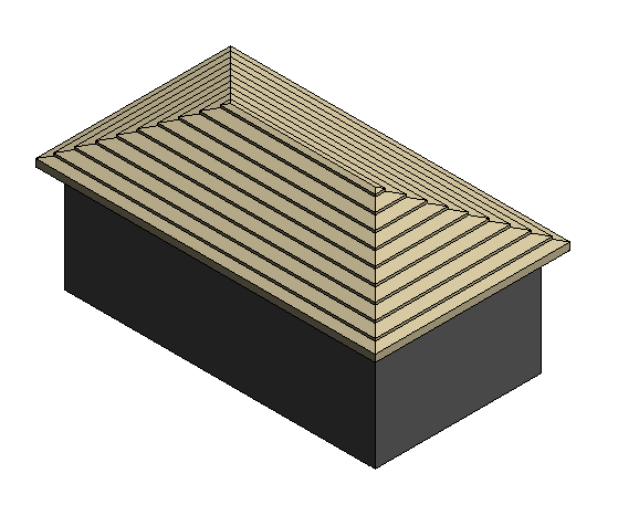

This was done in 5 minutes using a sweep

Thanks mbsteve: although that works for that specific building shape, what I was looking for is an adjustable profile which can be used on varying wall angles (say 30 or 120 degrees rather than just 90) and varying distances between walls. I'm looking for a way to add multiple Bermuda roofs to separate, different buildings in a model - maybe a curtain panel of roof slates would work?

Has anyone done this?  I'm a little lost, but I have the same problem.  I would like to model a bermuda roof, but a sweep won't work because it is not a simple roof.  I've never created a conceptual mass family... It seems difficult.  Creating a stepped roof should be easier!

Use a gutter profile, you will have to create a new one for every roof that varies in span or slope. You will need to cut sections through each roof and give each gutter profile the same exact dimension that you measure on your section. I generally go about 1/32" smaller to avoid issues when trying to miter the gutters (which it will do automatically).
