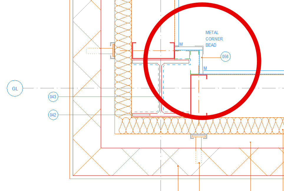

Is it possible to add wrapping to a structural UC where it meets the external wall.  The aim is to have the plasterboard follow the line of the column forming a 'box-out.I know this can be done on an architectural column but it doesn't appear to be the same for the structural equivalentThanksRMH1981

I would probably do this with a parametric family.  You could play with a U shaped architectural coulmn ... that might even work better.

thanks WWhub,
we've found it easier for now making an architectural column with offsets and dropping it in over the structure....
