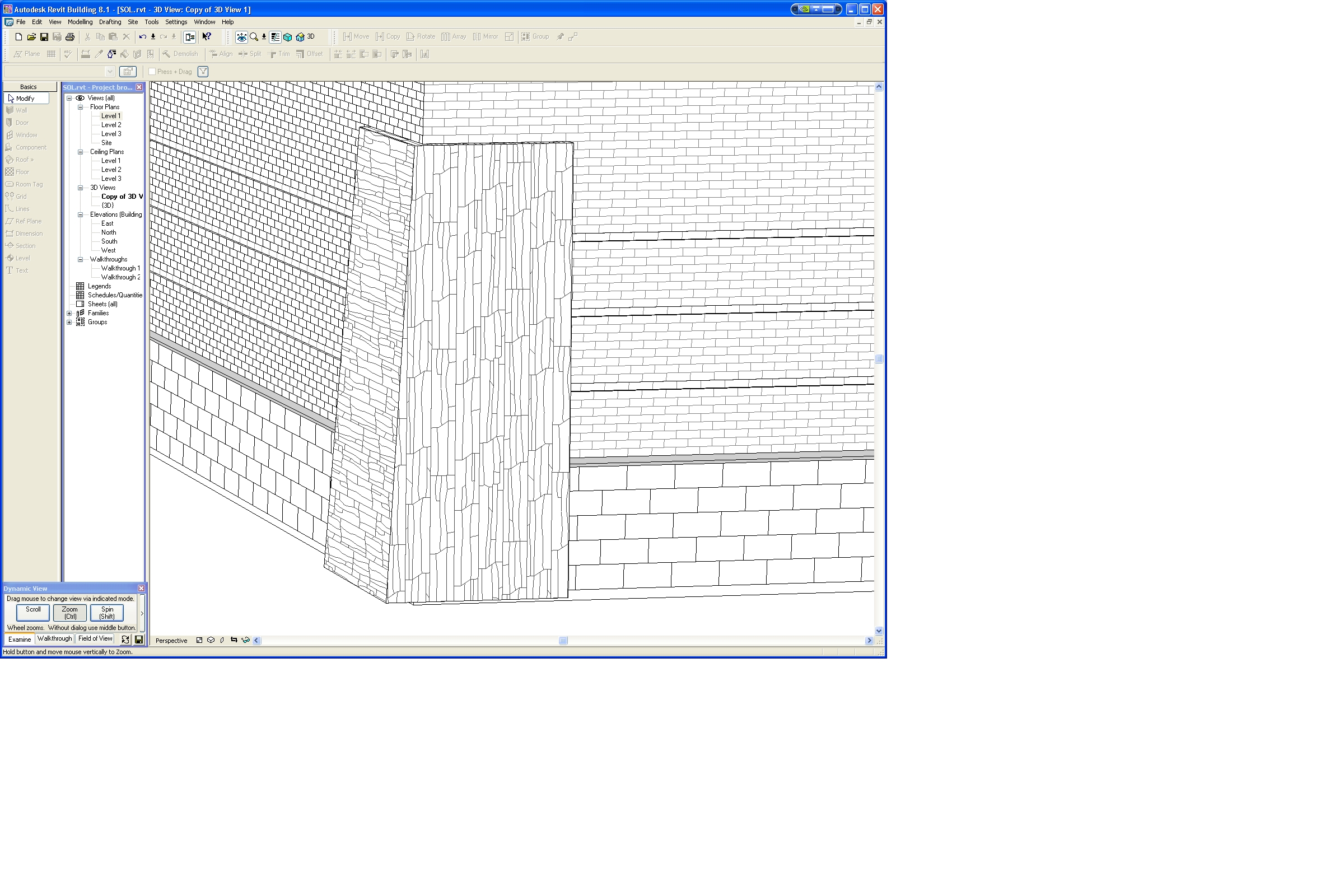

Can someone explain why and how to fix my hatch on a in-place wall sweep. The hatch shows up fine on one side of the of the sweep but on another leg of the path the hatch gets turned 90 degrees. Please see the attached file.

Use the Align tool Select a horizontal element on the correct one first then select a vertical element in the wrong one. Post edited on 2005-11-04 15:06:34

Thanks. I'll try it out.
