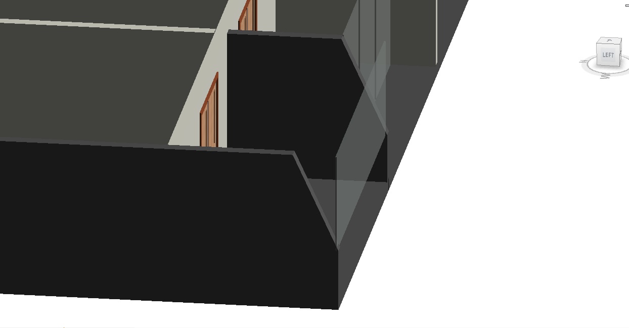

I'm new to Revit Architecture and I have a problem with a curtain wall that I want in an angle.
I want the curtain wall to be set in an angle so that it 's connected to two other walls to form a room. See the picture below.
 I'm sure there is a way to do this and it is probably very easy, but I can't seem to figure it out to make the wall angled.
Thanks in advance

Create a "Mass" with that shape and angle then apply a "Curtain System" by face

Exactly how I would do it

Thanks Typhoon! I'll try that.

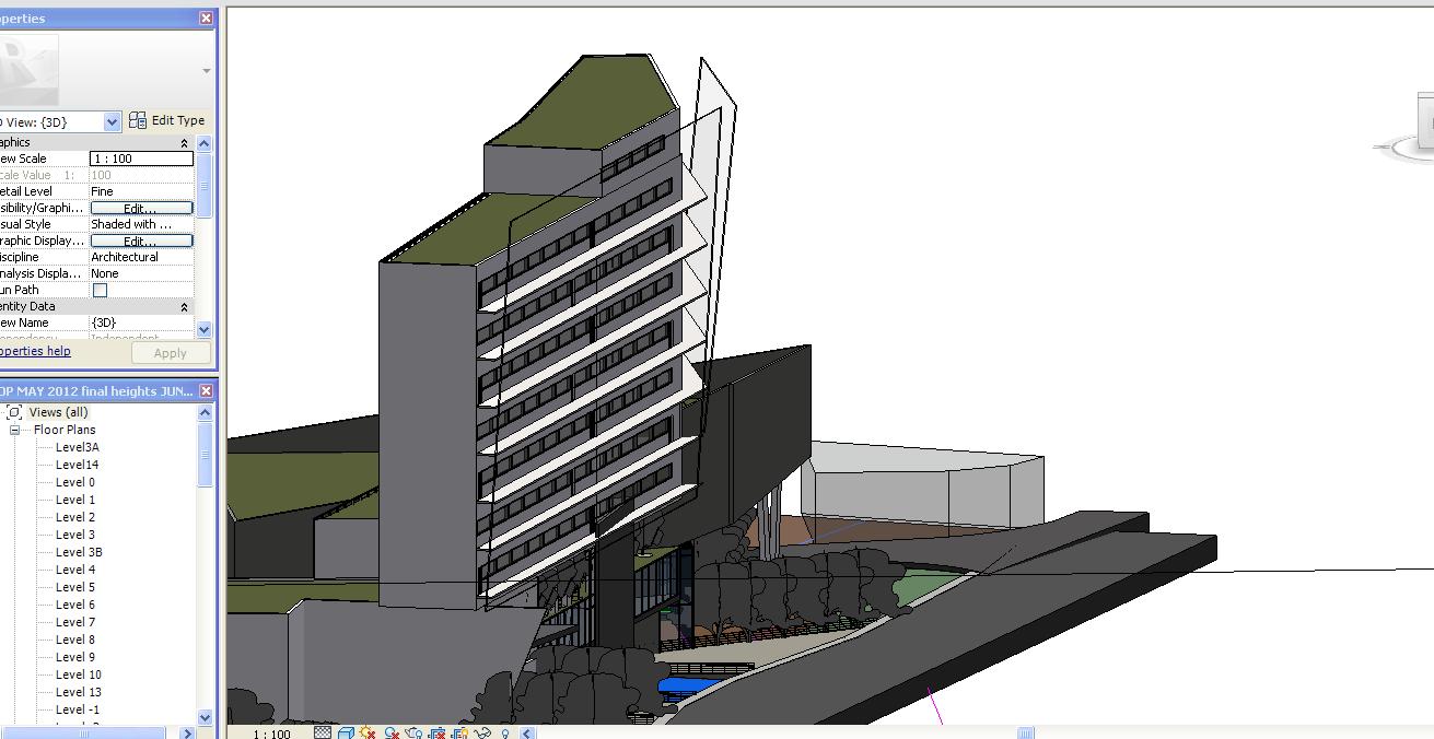

hi i am trying to creaed a curtain wall in an angle so it will look like its tilting at the frond of my building around 120 degrees angle can someone explain me how to do that?
as much detail as possible would be much appritiated or even any videos on doing it as well
am submiting a compedition in 2 weeks and am really stressed

Can't you use a mass then apply curtain system by face? Images of what you want please...

here is a print screen image of the model
as you can see i would like to add curtain wall system on the facade of the building
i can edit a wall into the shape i want but i cannot do the same with curtain walls!

Create a MASS then use Curtain system by face, very simple...
Watch the video: http://screencast.com/t/oC9Xge0jiBe
