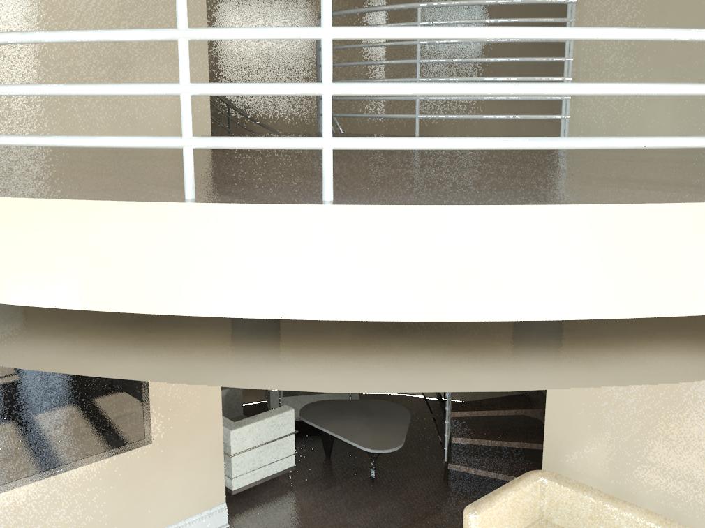

Just playing around with Revit 2010. Trying to close off a ceiling edge. Have a mezzanine with curved floor / ceiling but need to finish off ceiling face around the perimeter. Some kind of strip or flashing but not sure how to do it, im sure there is an easy method.
Thanks in advance
Jon

You will need to create that with an "In-Place" family in category "Ceilings" then use the "Solid Sweep"
Watch the video:  http://screencast.com/t/Ma0AJ5c9bg

Thats extreamly helpfull thanks Typhoon, you have answered my query perfectly!
