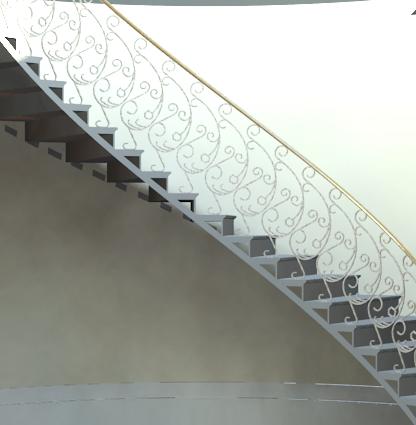

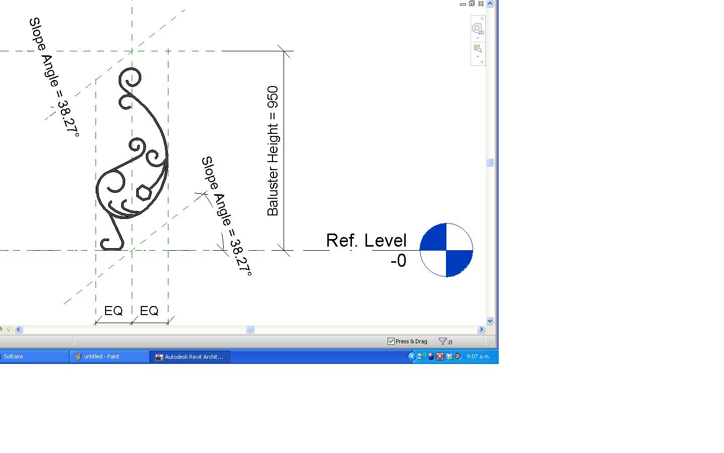

Hi there,
I've been building a baluster and railing for my staircase and it's all performing well (finally!) apart from when I set it to render last night it isn't taking on the 'iron black' properties that I gave it. Basically, I need it to render black, not grey which it seems to be doing.
It might look as though its because of the natural light in the render attached, but I've tried a few variations.  I've attached a context shot (line drawing), to show what it should look like, my failed render and the file that I need to adapt in case anyone wants to have a go. I'm keen to hear any and all advice!

Did u assign any material into the baluster inside the family editor?
Wed, Jan 19, 2011 at 2:33:49 PM | I"M HAVING DIFFICULTY CHANGING THE RENDER COLOUR OF MY BALUSTER/STAIRCASE
CRB14
Joined: Fri, Oct 22, 2010
86 Posts
hi, yes i applied the material to the family i created before loading it into the main project. this worked for the railing, but unfortunately not for the baluster detail...

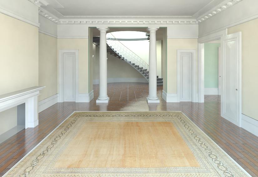

BTW, how did you create your floor pattern adjacent to the staircase? is it done thru modeling or it is an image rendered inside of revit?
Wed, Jan 19, 2011 at 2:45:32 PM | I"M HAVING DIFFICULTY CHANGING THE RENDER COLOUR OF MY BALUSTER/STAIRCASE
CRB14
86 Posts
Ah Ok, I always wondered that. Now, my only issue with assigning a material in the project is that the baluster detail and railing highlight as one object. So I'm guessing that when I assign a material to the baluster, the railing will also take on that material......I'll give it a crack though, thanks
Wed, Jan 19, 2011 at 2:54:18 PM | I"M HAVING DIFFICULTY CHANGING THE RENDER COLOUR OF MY BALUSTER/STAIRCASE
CRB14
86 Posts
That has also been a bit of a nightmare. Basically I had to create a custom pattern, and when I tried doing this on Revit with formulas etc etc it drove me crazy so I ended up creating individual tiles for each wood piece in the pattern. This is probably why my file is so large.....
If you have any ideas about how to do this without using the pattern tool in Revit too that would be awesome! So yes, done through modelling.....very slowly....

Hmmmm still not having much luck. Tried changing the material and doing a high render and see below for outcome...
I go: Manage>Materials>Metal (system)>Change the material to Metal (Iron Black)>Apply....

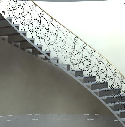

Wed, Jan 19, 2011 at 4:28:51 PM | I"M HAVING DIFFICULTY CHANGING THE RENDER COLOUR OF MY BALUSTER/STAIRCASE
#13
CRB14
86 Posts
Thanks so much this is great - I'm having difficulty figuring out what the family editor is you are referring to? Currently I can open just the baluster by itself, or I can click on the entire railing & baluster from within my project and go to the type Properties? But I don't think this is what you mean.....
Wed, Jan 19, 2011 at 4:37:33 PM | I"M HAVING DIFFICULTY CHANGING THE RENDER COLOUR OF MY BALUSTER/STAIRCASE
#14
CRB14
86 Posts

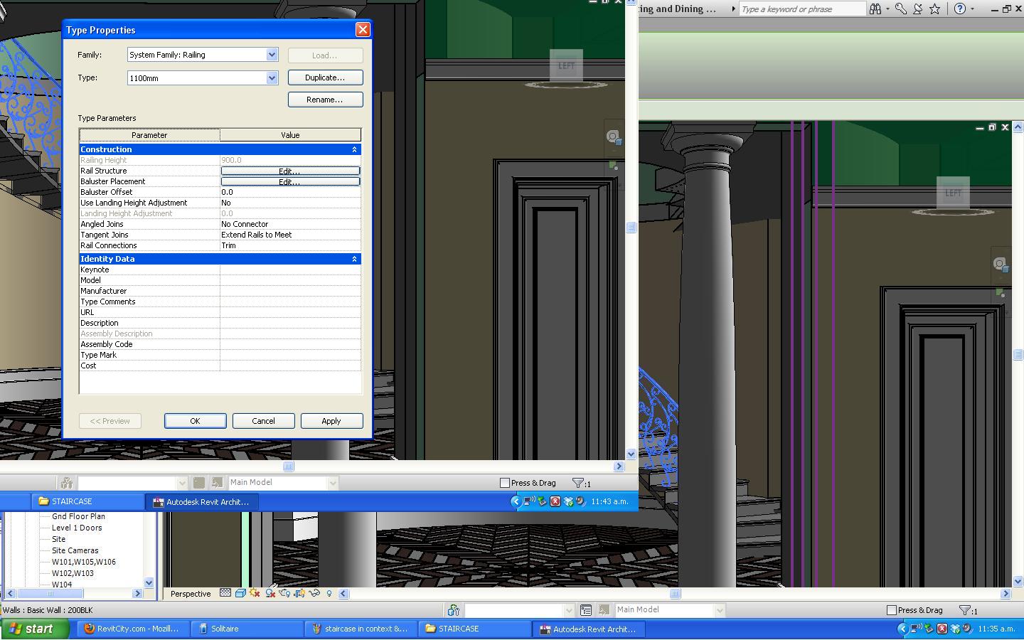

Sorry, still having difficulty. When I select the baluster in the project, I'm struggling 'to locate the baluster family from the project browser under families'.Where do I find the 'families' tool...?
See attached image for the menu I get up when I click 'Edit Type'
Edited on: Wed, Jan 19, 2011 at 4:42:01 PM
Edited on: Wed, Jan 19, 2011 at 4:44:20 PM
Wed, Jan 19, 2011 at 4:52:18 PM | I"M HAVING DIFFICULTY CHANGING THE RENDER COLOUR OF MY BALUSTER/STAIRCASE
#15
CRB14
86 Posts
Awesome! Sorry it took me a second till I saw the attachment you sent. Much much appreciated! See render for outcome....still annoyed I couldn't figure it out though! Champion, thank you
