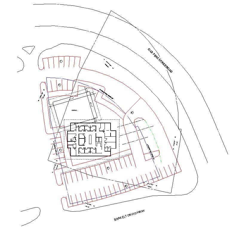

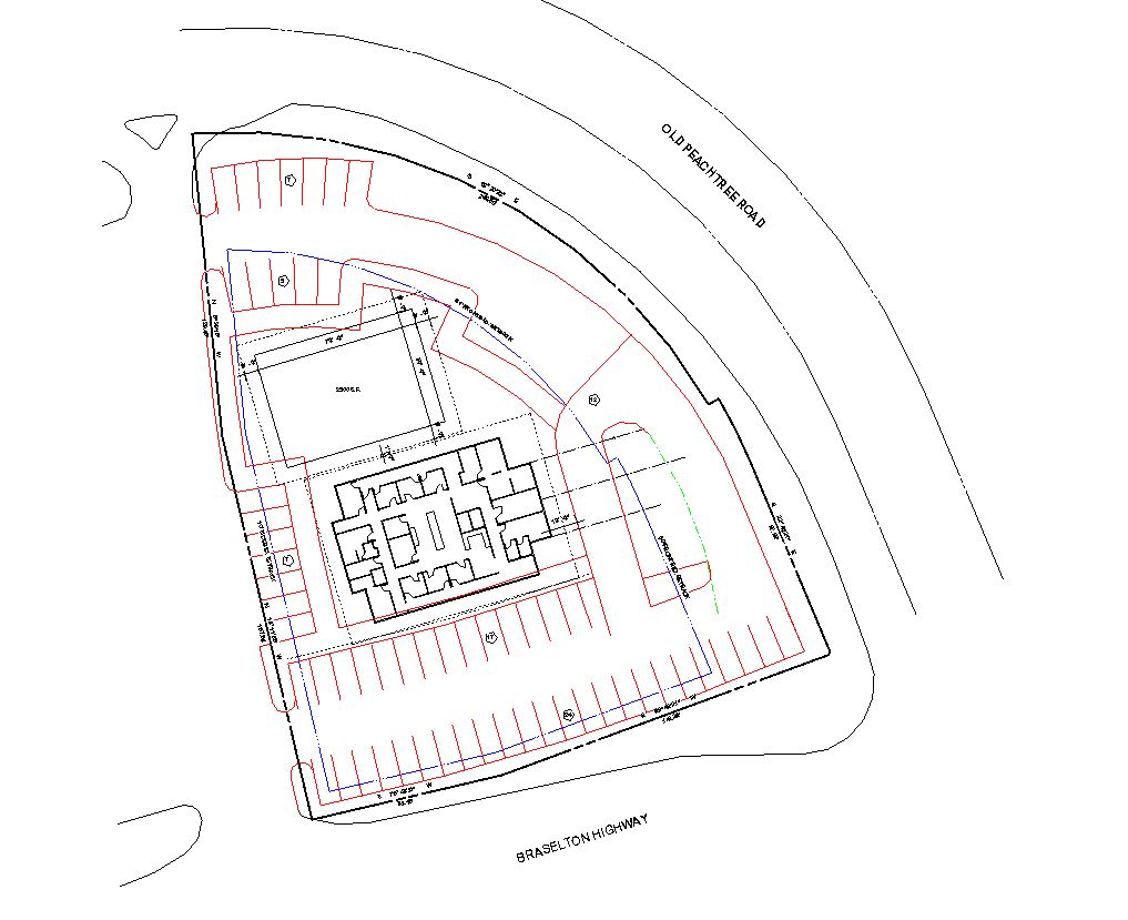

I am drawing a site plan at the moment.  First I am sketching out the lines of the curbs and and parking spaces with detail lines in a site plan view (not a drafting view).  I have the building placed on the site as a group made from detail lines as well.  The view is currently set to true north and is drawn with north going straight up.  I make a copy of the view and set the view to project north.  I then go to the rotate project north tool and select the building line that I want to be going east/west so its easier to draw orthographically.  When I click the building line it only rotates the building foot print and property lines. It leaves all my other details lines where they were and messes everything up (see screenshots).
Any suggestions?

I don't think detail lines will rotate the way you're doing it because the rotate project north command is rotating the model.  Detail lines are just 2d lines drawn on only one view and don't have any real location in the model.  You have to use the rotate command on the modify tab for those types of elements.  I wouldn't recommend using 2D lines for this because they will not be an actual part of your model.
