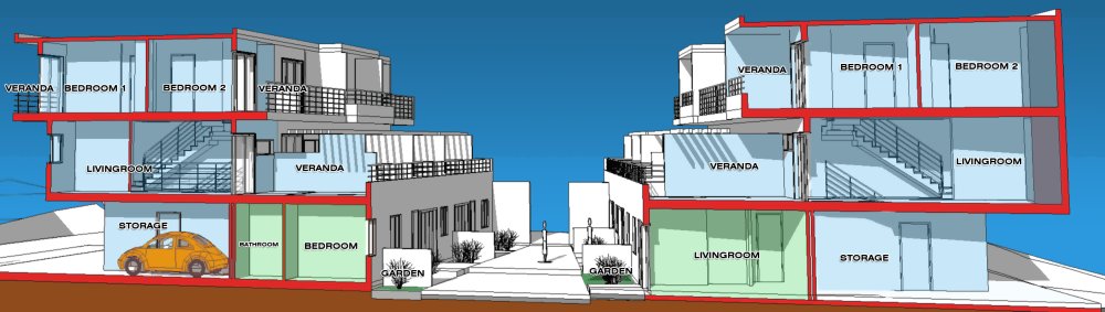

Create camera/perspective 3D view and activate "section box" option in View Proprieties. Rotate, scale section box as you like. Use F8/view controls to adjust the view

moneos
Joined: Wed, Jun 22, 2005
3 Posts
This is what I've got using method described before in my previous post. Picture done with Revit and Photoshop.
