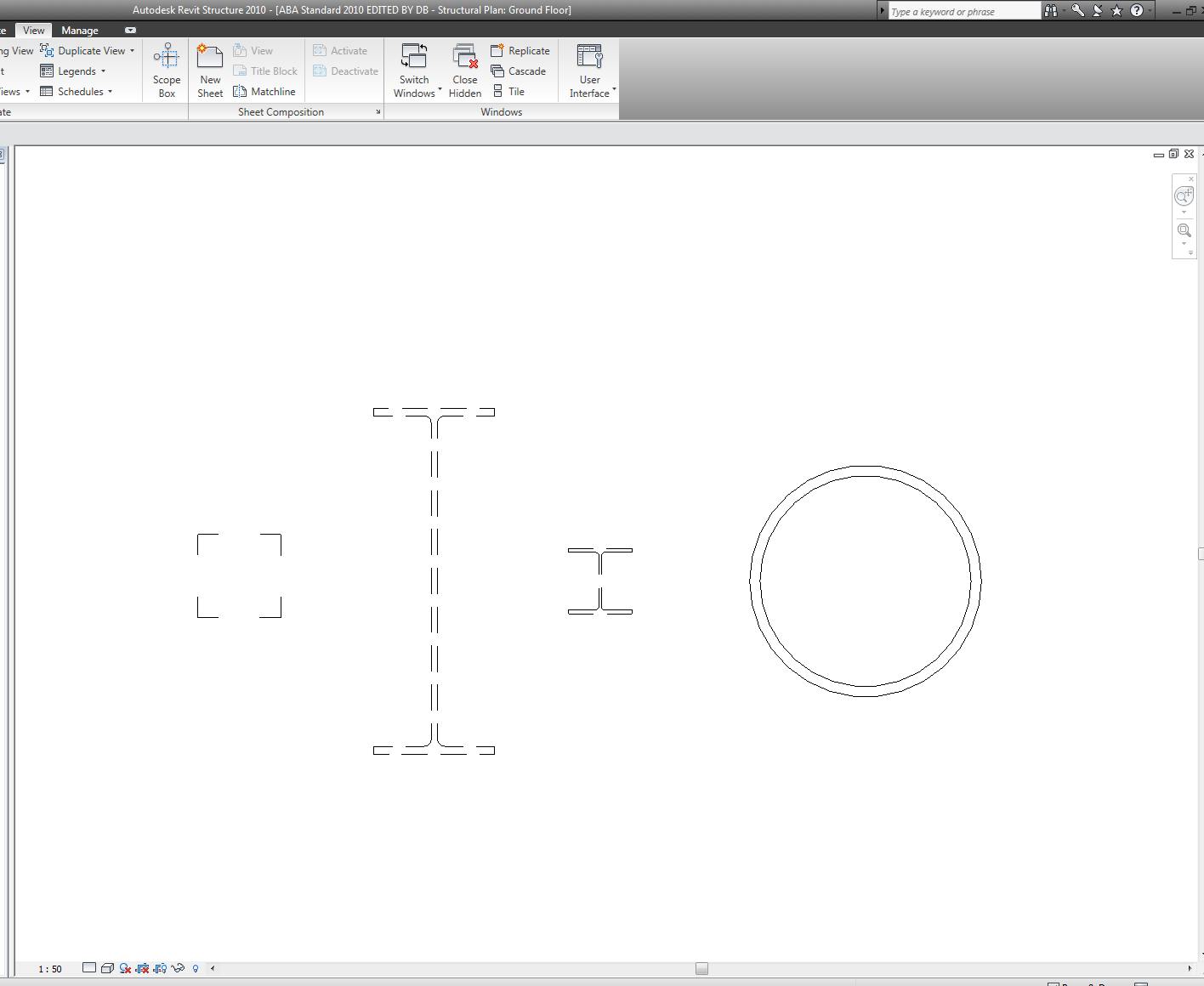

I an trying to sort out the REVIT standards for my office, setting up templates so that everyone is using the same line styles etc.
The problem I am having is with steel columns, when they are hidden. Basically I need to know where to control the hidden line style for steel columns. A little more background:
In visibility/graphics override I have set structural columns to show as fine view (even though the rest of the plan is in coarse)
I have put a concrete col, a UB, a UC and a CHS section all should be showing hidden (they come up to the underside of the slab)
The concrete col has the dashed linetype that is controled in object styles
The UB and UC show dashed but the linetype is not controlled in the Object styles
The CHS is showing solid
The hidden linetypes for the steels must be controlled somewhere but i can't figure out where. Any help would be much appreciated.
