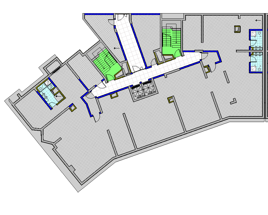

I've linked my structural elements to my project, I have deleted some structural walls from the basement level. And when I reloaded the link from the project, now I can see all the basement structural elements from the above levels (it's like from 4th level till all above levels). Anyone can help?

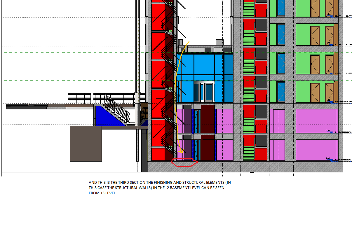

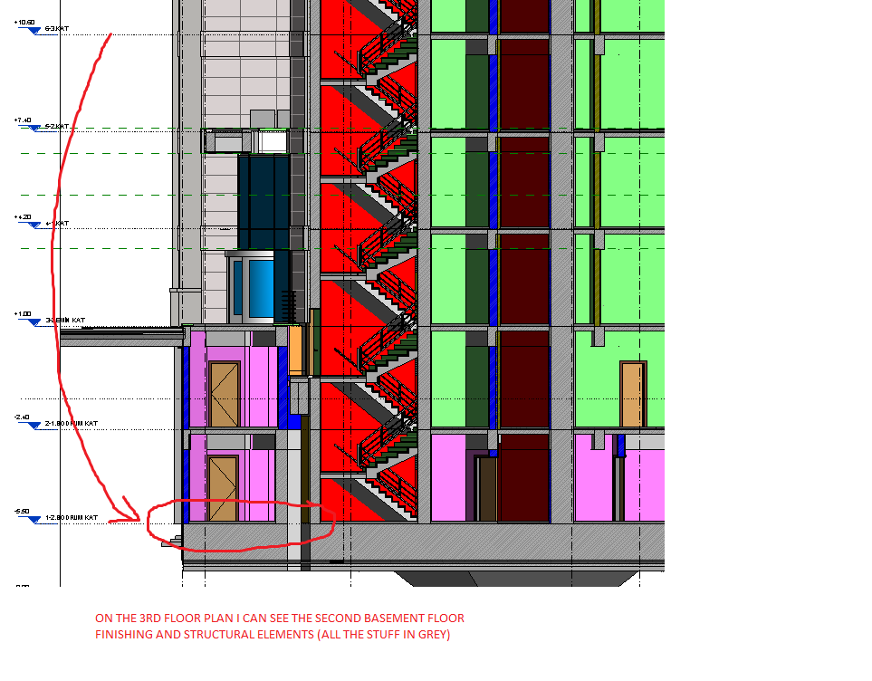

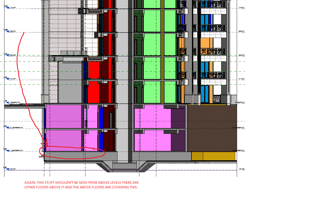

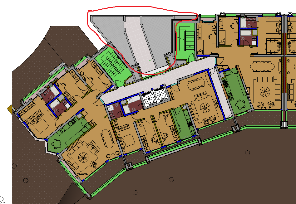

Ok then. I've just deleted a part of the building on a basement floor. And after I've saved the link file, I reloaded it again from the host project. And now I can see from the fifth floor or fourth or from all above levels, the basement. I shouldn't see the basement from the fifth floor right?
Attaching some images: the structural elements in the basement are visible from the above levels as seen in the second picture red marked area.

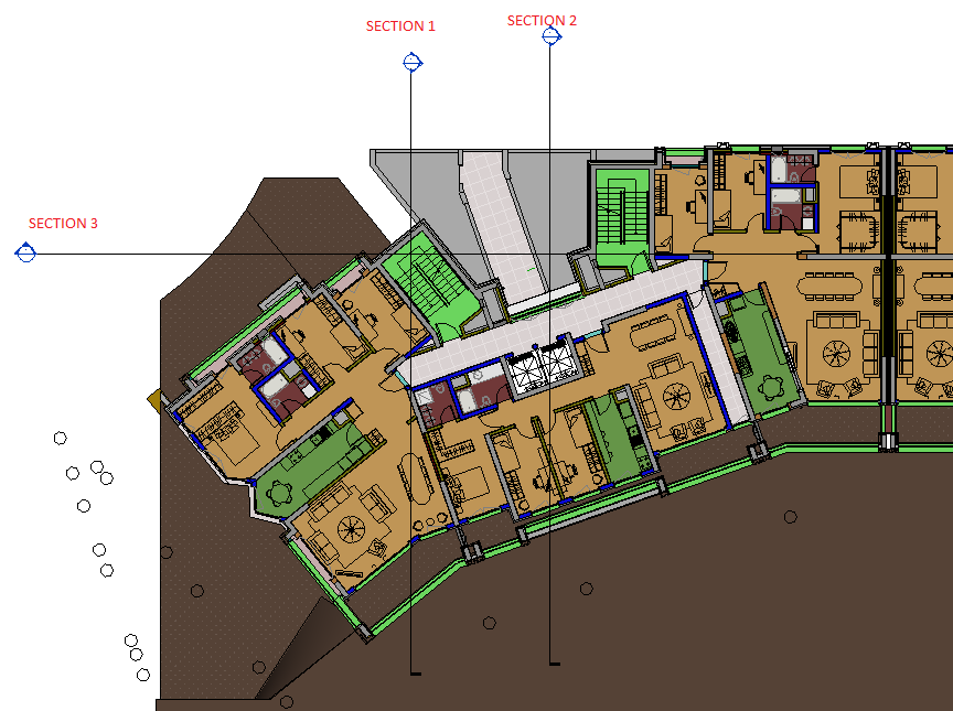

In the area that I circled red, there shouldn't be anything but I see there a partial basement plan. if I take a section from there everything looks ok, but if I go through plans I see stuff that shouldn't be there.
I'm sending a 3rd level plan and 3 sections to make it more clear. There are no roofs, nothing is hidden.
