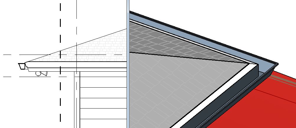

My gutter is perfectly mittered in the 3D view but on the Elevations, it displays only in section and not on the side view. (I see the fascia thats behind it instead) Please see the attached image showing how it displays on the 3D and on the Elevation. Why is this happening? Any ideas? Thank you.

This may be too obvious but have you checked to see if the elevation is cutting through the gutter. Go to the view with your elevation symbol and click on the arrow. Make sure the blue line showing the elevation cut line is pulled back away from the gutter.

Oh, my goodness! You guys are right, it was just that. I thought I had it right but just for a few inches it was wrong and the cut line was too close to the house. Thank you for being so helpful and sorry for me being so silly.
