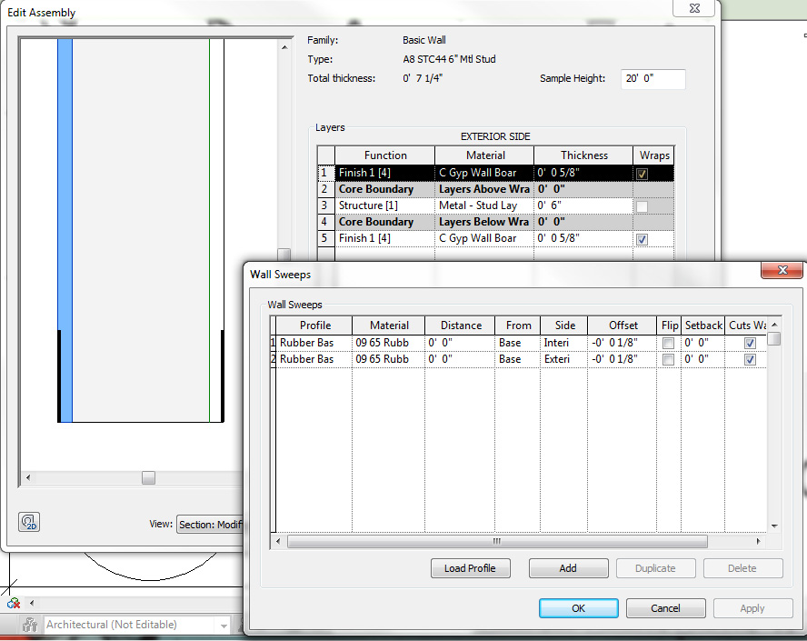

Here is what we've been doing at my office which seems to be successful for our projects: We model all our typical walls with a rubber base wall sweep on each side of the wall, offset by -0' 1/8" such that the base doesn't show up in plan but you can see it in elevation. When we need to use the wall for a soffit, we just duplicate the walltype and add suffix "- no base" to the wall name so it sorts in the model right under the same wall type with base. When a wall goes down to the foundation, or you can't see the base of the wall due to a step in the floor for instance, I use the type without base and use a wall hosted generic model called rubber base that stretches. I attached a photo that shows how we've been setting up our rubber base wall sweeps.
4" Rubber base in interior elevatiosn
