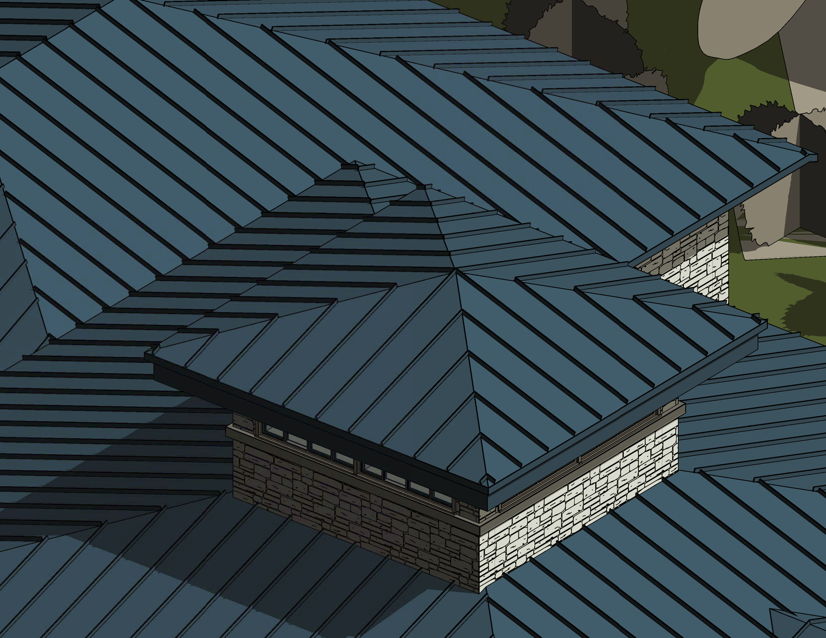

I will avoid using in-place family to create metal standing roof if possible. My method is to use slope glazing to create the "rib" of the seam. See attached image, all of the roof there are done in the same method, you don't have to mess with any section view, it is much easier to manage it using slope glazing even if you have it edit it later, and you can cut opening thru the roof just as easy.
The only down side is it will slow down the model, so I only recommend it if you have to show it  in details
Philip

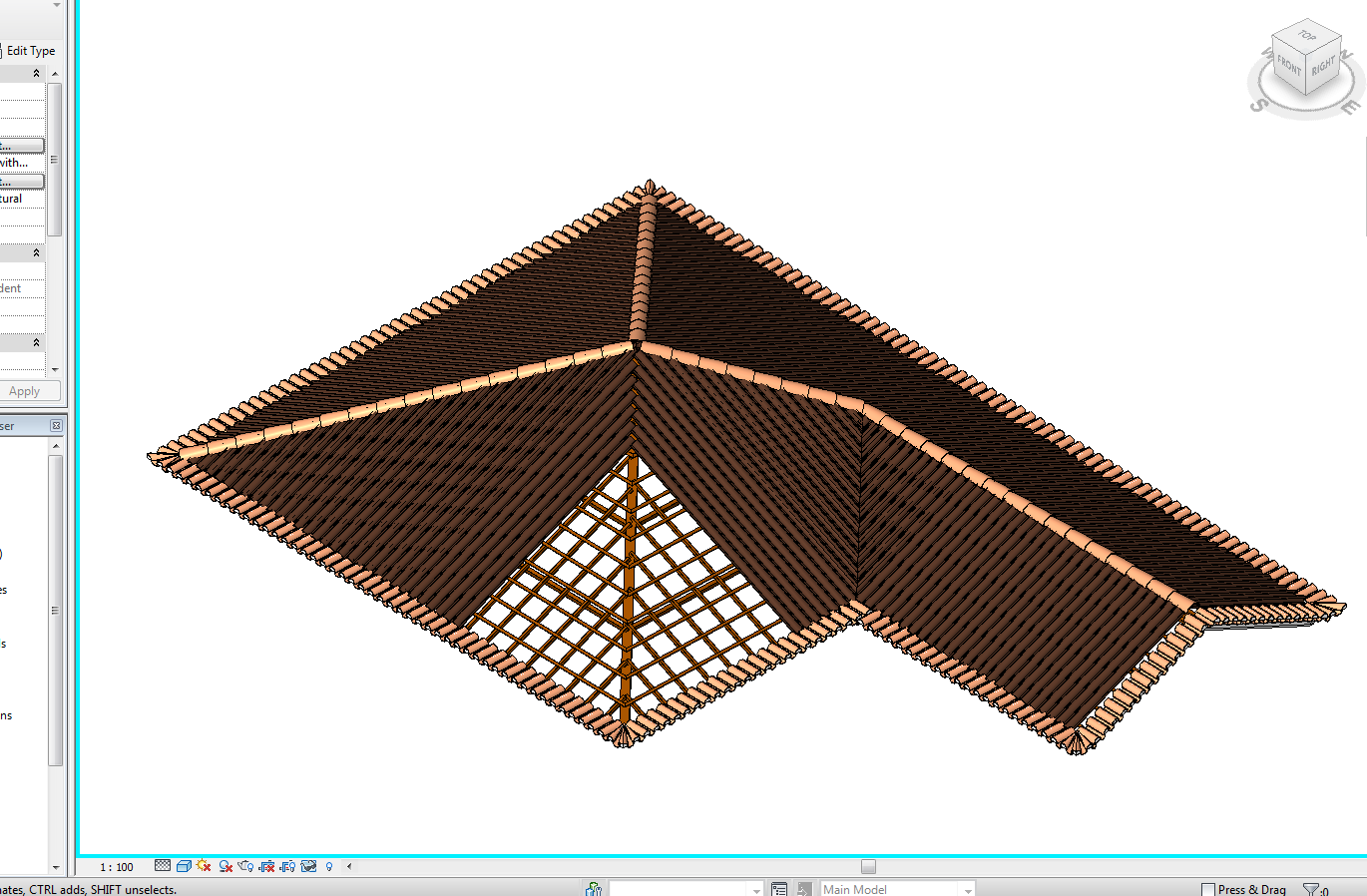

This was created with "sloped glazing" system

Typhoon, Ive seen this roof on many posts, and many links to your personal work. I wish there was someone who would describe in more detail. Like the awesome post by bimman. everytime I ask this question people link to one of the dead ends with a picture or a snide comment about textures, or what BIM is supposed to do...or portuguese.
Could you post maybe the panel library part, or part of the roof so people could look at it?
Thu, Jan 13, 2011 at 4:06:21 AM | Metal roof finish
#13
Joined: Tue, May 22, 2007
5921 Posts
4 Stars: 205 Votes
"Could you post maybe the panel library part, or part of the roof so people could look at it?" - Sure, look at here and download those 3 RAR files (Cobertura_Part1.rar.....) : http://www.revitcity.com/forums.php?action=viewthread&thread_id=1862&start=30
