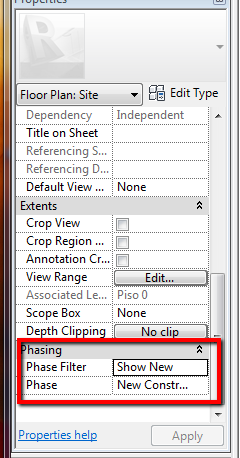

In order to have the existing topography and then the new grade lines, I created a graded region on top of the existing topography. I also created a new toposurface for an area of the driveway that had an upward slope. I also created a subregion on top of all this in order to have a driveway.
Well, everything displays right in 3D but on the Site plan, I only see the existing topography that displays in hidden lines.  The View range on this Proposed Site plan is set to match the level of the Top of floor of the house allthough with an offset of a few feet above it to be able to see the sloping topography. Anyway, I can't see the Graded region, nor the subregion nor the new toposurface. I only see the existing topography no matter what level I use as a view.
Somebody knows what can be happening?
Thank you,

In that view did you check the "Phasing"?

You are right! As soon as I change to Show New, I can see the new grading but I had it in Show All and I was only able to see the existing grading and not all including the new grading. Why is this happening? A bug in Revit 2010?

There is absolutely no way to show grade lines from an existing phase along with the new grade lines. I choose Show all and nothing happens, then Show previous + New and nothing again. A typical way following architectural standards is to show existing grade lines in hidden lines and new in continuous lines all together in the proposed grading plan. But there no way to do this in Revit!
