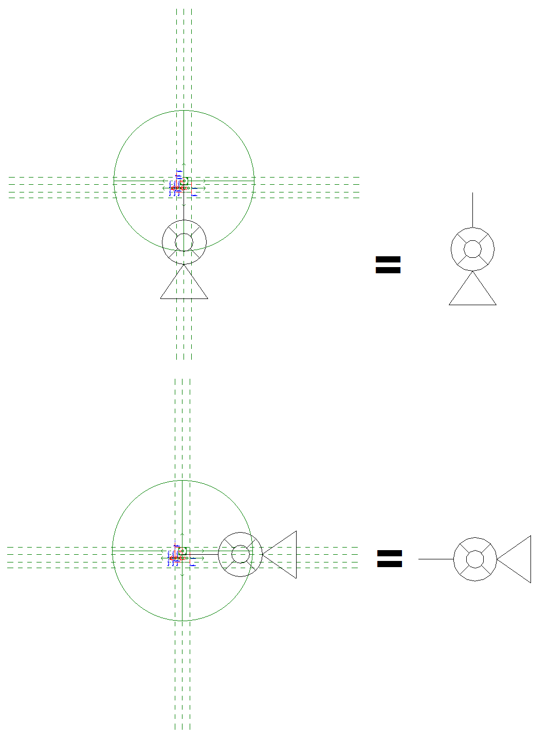

The annotation symbol comes into the Legend view however it appears in the Ref. Level view of the family.  All you would have to do is rotate the geometry/symbol in the family.
