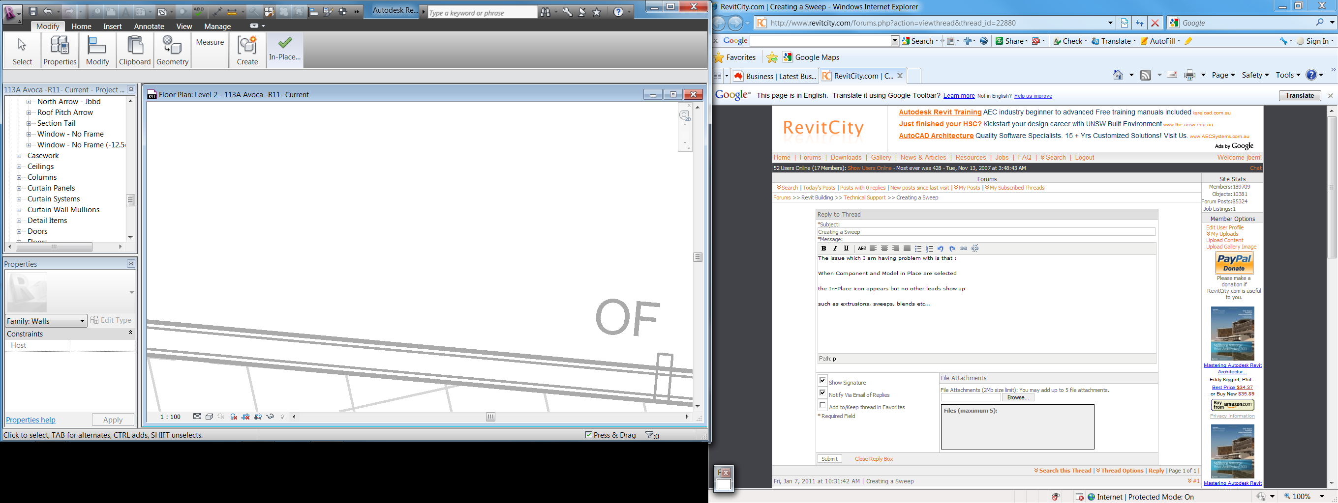

The issue which I am having problem with is that :
When Component and Model in Place are selected
the In-Place icon appears but no other leads show up
such as extrusions, sweeps, blends etc...
Copy of screen attached.

Now in that menu (Ribbon) select the "Home" tab and you will see the Sweep, blend and so on...
Mon, Jan 10, 2011 at 12:49:50 AM | Creating a Sweep
jberri
27 Posts
Many thanks for your help.
Selecting the Home tab twice.
That's what I was failed to see.
