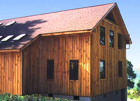

I am interested what is the easiest way to make such wall
 I want to have graphical representation in facade views mostly
Wall detail view would be nice but isnt necesarry
but if it's easy enough - any tips on making such wall would be great (second picture)

Set the material you specify for the external wall as a vertical wood board, with a surface hatch as vertical lines, this should take care of the elevations. Use repeated details of the battens, counter battens & boarding in plan/section
