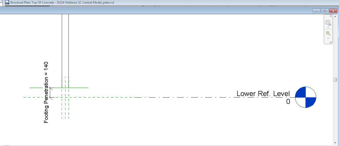

I found a solution.
Edit the STR Column Family so the BTM Ref level is Below a newly created Ref. Line with a parametric dim. to allow the attachment point of the footing to be above the base of the column. see pic.
You can then adjust the 'z' offset to meet the top of the footing.
