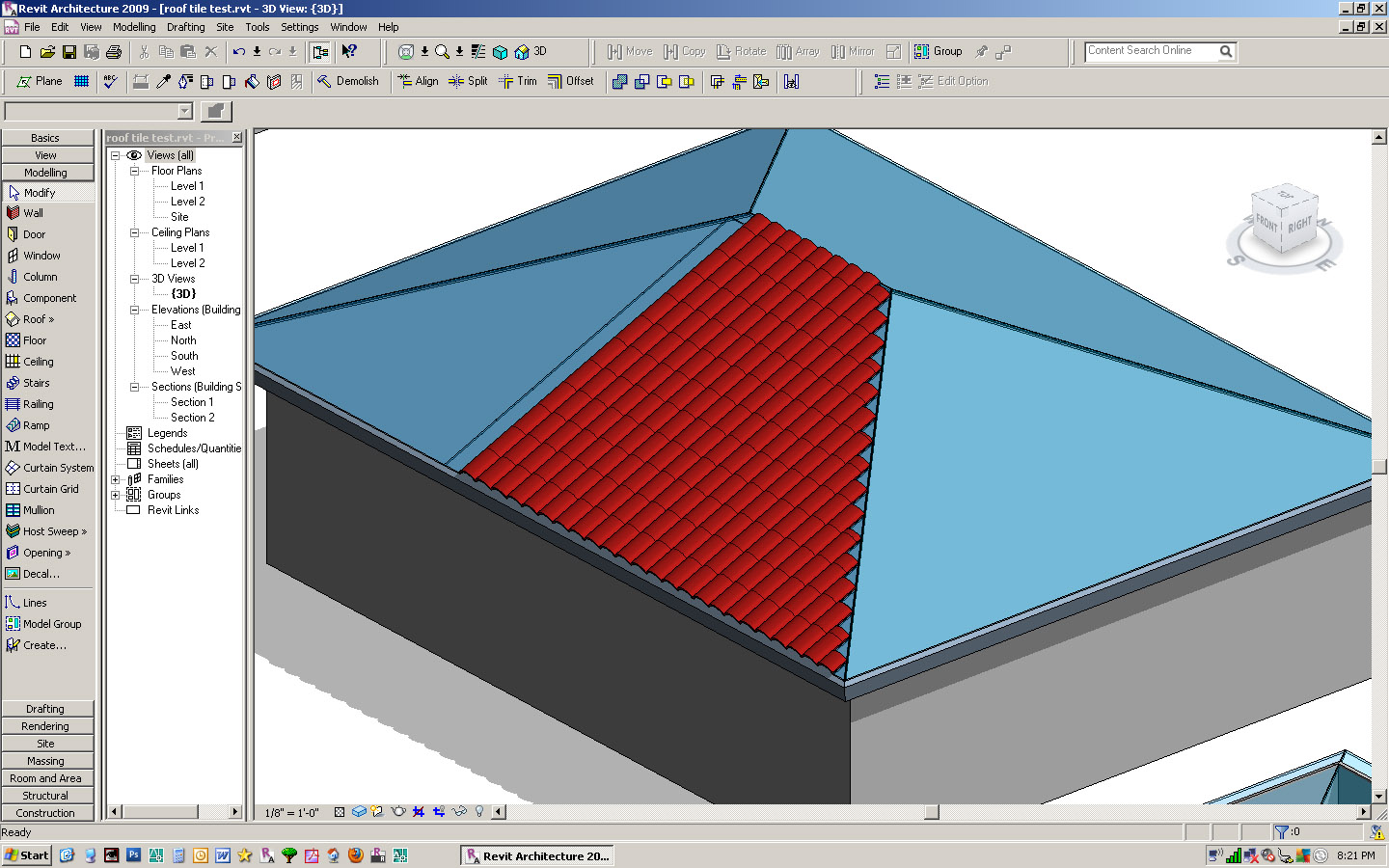

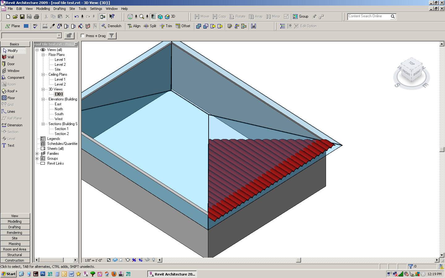

I want to make a mission tile roof. Every post ive found on this site has been vague so I have tried various approaches.
 This time ive created a roof by extrusion, using a repeating long barrel shape to cover the roof plane. but its flat, how can you then give the roof by extrusion a slope. I cant rotate it in section to match the sub roof (in grey) nor can you draw the extrusion in a plane other than facing front (or right,left etc)
see the image where Im at.

I respect everything you've said, Ive also read those exact words on the other posts. ive done all that it states with the textures and renderings, ive also downloaded the tile panel and used that too. I just want an answer to a simple techincal question, and all I need is a: "yes or no, you can tilt the extrusion or no, you have to use another tool to build that object"
so one more time: Ignore the fact that my roof is a barrel tile shape, can a flat roof extrision be tilted up to match a roof slope?  or any other angle for that matter?

Update: here is an image of barrel tiles as a certain wall panel . just have the single tile extrusion height locked to the top and bottom. Use a 18" parallel line pattern on them. Ill make the ridges from a sigle library object im gonna make to cover the edges.
 one could then save it as a seperate project linked into your main, while most of the time you use a basic roof form or something. you could use the options. I might try this on my actual project and see how much bogging down I actually get. so far the shadows snap on right away without the progress bar...but its only this single model.

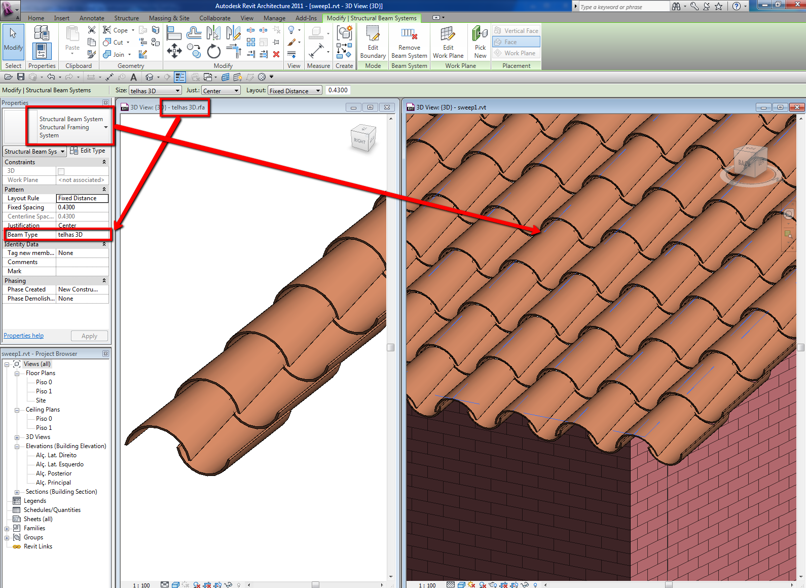

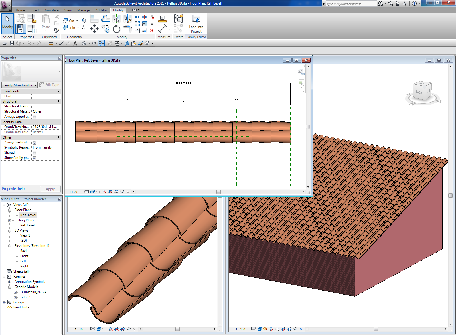

There is another way to create those Spanish tiles more realistic, using the "Beam System" and creating a new family "Structural Framing - Beams and Braces" like you can see in my images BUT this increases the file size, so, a good texture some times is better than this.
Watch this video: http://www.youtube.com/watch?v=JgCat_mzUwg
he don't show the process because he want to sell the DVD with the families and the videos where he explain that but this is the way he use "Beam system"
