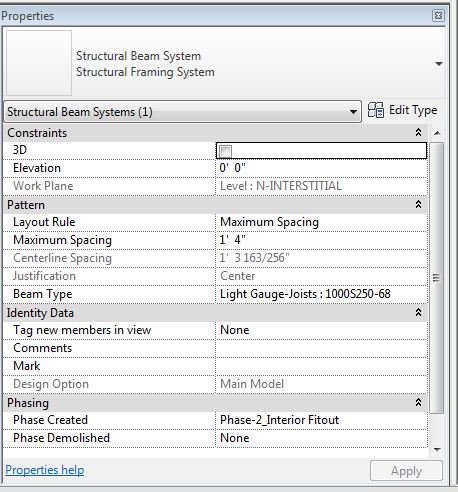

Hi,
I can not extract the data from the beam system. How Can I get schedule of Beam System?
Is there any Work around?
Please give a solution for this thread.
Thank You

Would you be more specific as to what information you are trying to extract and schedule?

Like Length and Width of the Beam system, Beam spacing etc.

I would start by setting up your schedule to pull parameters from the beam system already in place - see attached pic.  The problem with trying to get a length and width of a beam system is you can have an irregular shaped boundary making up the beam system.  You could use the structural framing schedule to schedule lengths of individual members within the beam system.
