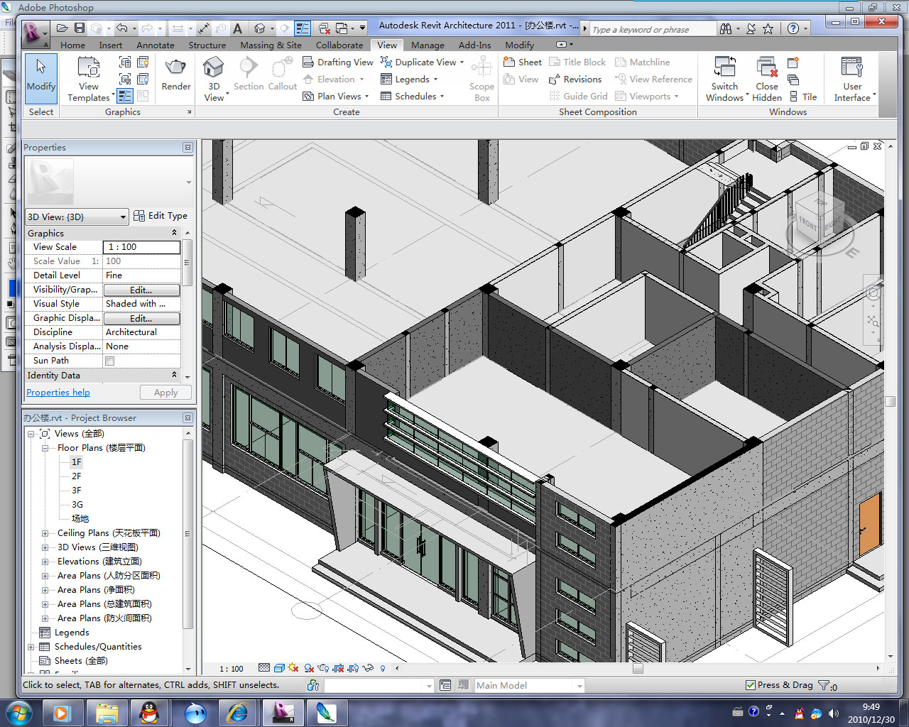

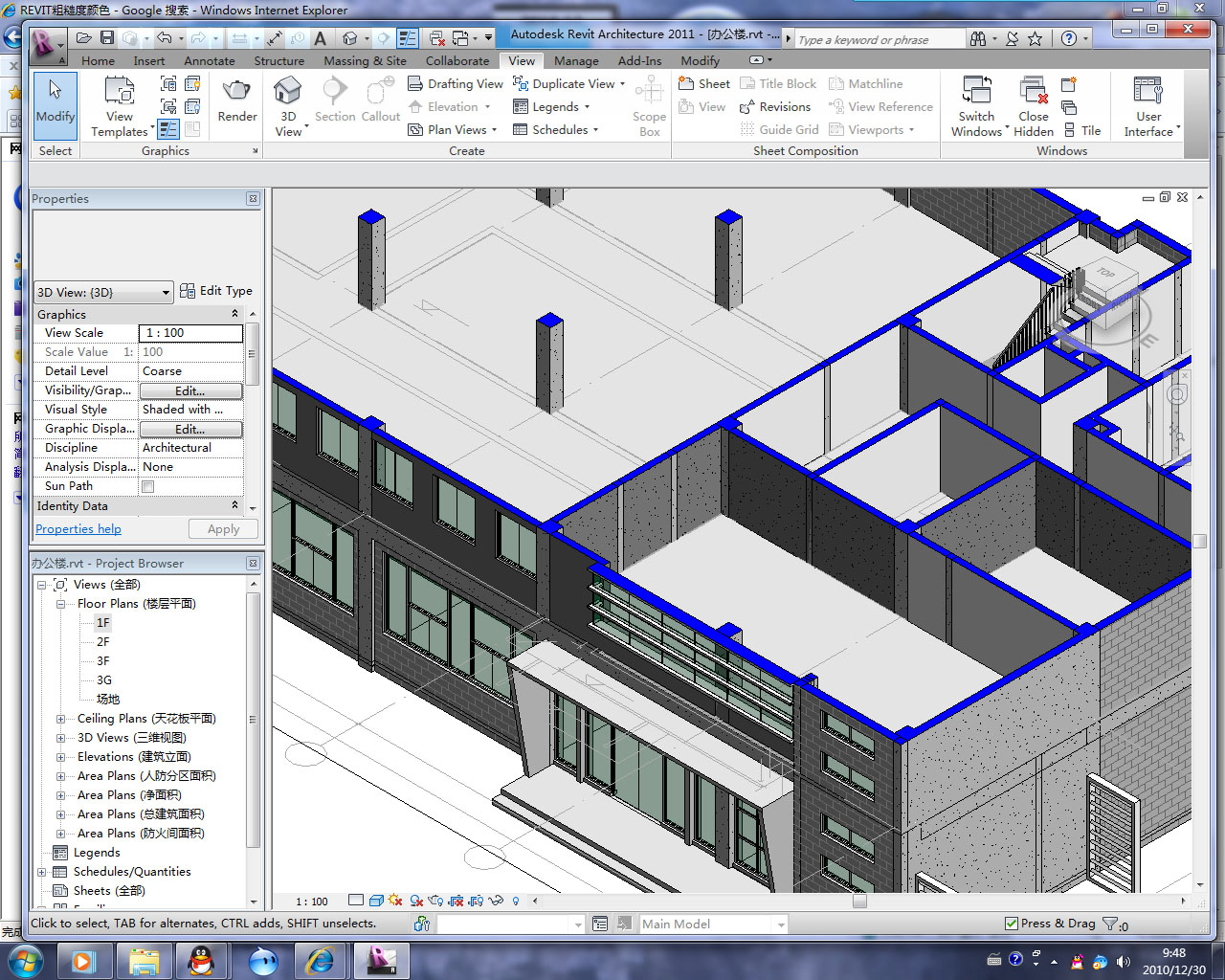

My colleague met a problem lately on appearance lately.

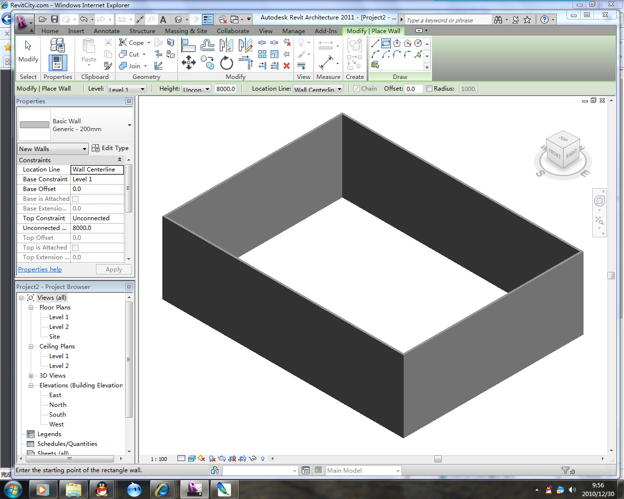

The building's walls and columns, even railings appear blue in a coarse setting while they look correct setting in fine. I use REVIT Default file to create a new wall, no problem with it.
 So does anyone know how to fix it? any setting?

Go to Materials and change the color of "POCHE" material
