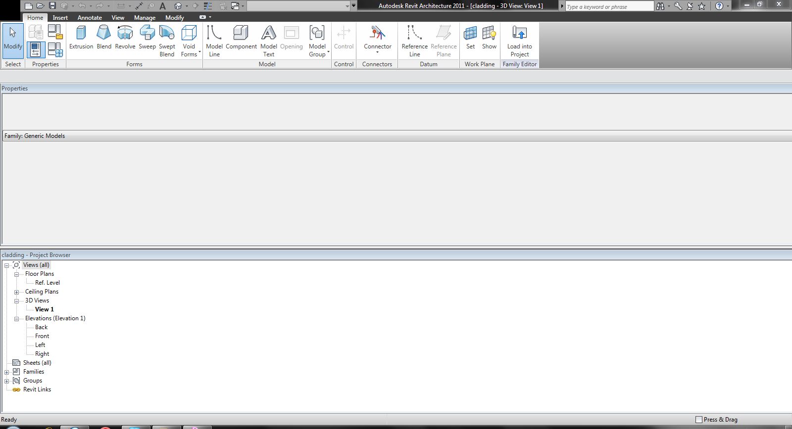

Hello everybody. I have a big rpoblem with my Revit 2011. It used to work fine for some time now but suddenly it went wrong. When i open a project or a family I CAN NOT see the actual view or plan. I see only the Properties window and the Project Browser windows stretched all over across the screen. I can not open any views or see any of my work. Additionally the explorer crushes too.  Where is the problem? Is it my video card Gforce GT 330M? Revit says it is not suported. Plus I use Intel i5 M560. PLs help me.
I have attached screenshot.

Here you have the solution: http://www.revitcity.com/forums.php?action=viewthread&thread_id=21772

Thank you very very much !!! Happy new year  and best wishes to u!
