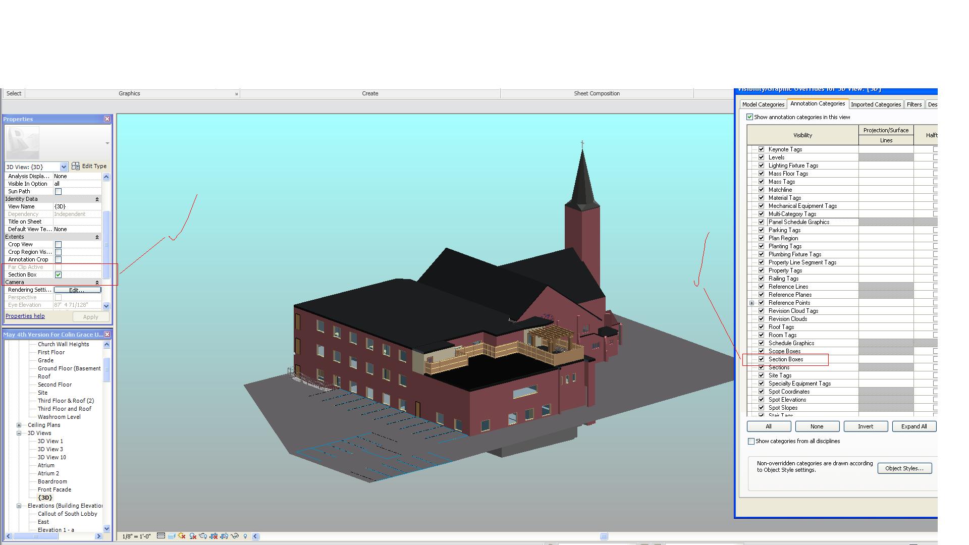

For some reason i cannot see my section box, it still functions per se, but I CANNOT PHYSICALLY SEE IT. Has anyone encountered this? Any suggestions would be greatly appreciated.

Ya, i tried that.
Wed, Dec 29, 2010 at 1:53:41 PM | My Section Box is Invisible? ! ?
JonathanRevit4
Joined: Mon, May 3, 2010
20 Posts
heres a screen
Wed, Dec 29, 2010 at 2:39:21 PM | My Section Box is Invisible? ! ?
itsmyalterego
itsmyalterego Avatar
Joined: Thu, May 28, 2009
829 Posts
4 Stars: 16 Votes
unchecking and rechecking the box has a good chance of bringing it back.

No luck. Sad

Next I'd try duplicating the view.

Still no luck, any more suggestions short of reloading the program?

Have you been overriding objects in view, by element lately?  You might have inadvertently had the section box selected, and set it to invisible?  You could hit the lightbulb at the bottom of the view to reveal hidden objects, and see if it's there.
Otherwise, you could go to the view tab and create a new default 3D view, and check if the section box is working in a fresh non-duplicated view.
Another possibility is that your section box was reset, and the extents of your project are much larger than you realize... through imported objects, or mistakenly moving an object a mile.. eh... but by the viewcube, hit the home button, or zoom to fit.  This should reset your view to show the extents, and hopefully your section box.  reinstalling would be a pain, and the problem probably rests with your file in some way, anyway.

Thank you for continuing to reply, its seems somehow it was hidden as an individual object, i fixed it now. That was my fault sorry.
