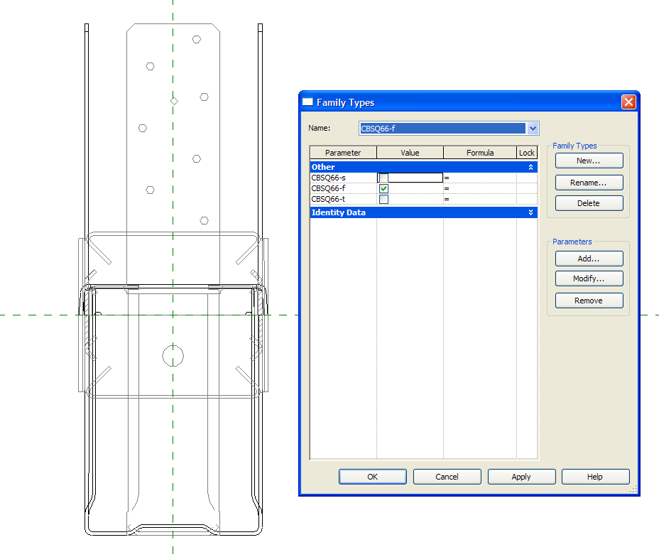

One thing that I should add is that after setting the visibility in the last step, I create a group of the entire seal.  That way I can distinguish between the line work and text of the different seals.  If you need to edit the group, insert another copy of the group off to the side and edit that.  After you save the changes the original is changed and you can delete the copy. I use this technique for seals from different states.  If all that you are changing is the name and registration number you can just have that information in the yes/no parameter and not duplicate the line work which will help to keep the file smaller.  The yes/no parameter is very useful and I use it in a lot of my families.  For instance I create Simpson hardware by importing the dwg file from the Simpson web site and use the y/n to select which view shows.  Make sure you purge when you are done to get rid of the dwg file.
