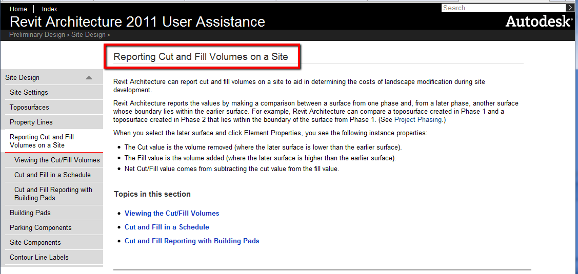

I am using Reit 2009. I have created a topographical Surface. I have split this surface to create a seperate hill on my site.
I need to calculate the volume of this hill. Anyone know how to calculate the volume of a topographical surface/
Thank you

From your HELP menu:
Wed, Dec 22, 2010 at 1:09:53 PM | Volume Site Computation
I believe that if you had used the grading tool, this information would have come right out of Revit.  Read this topic in your HELP... Reporting Cut and Fill Volumes on a Site
Your H E L P is always the best place to start looking.
