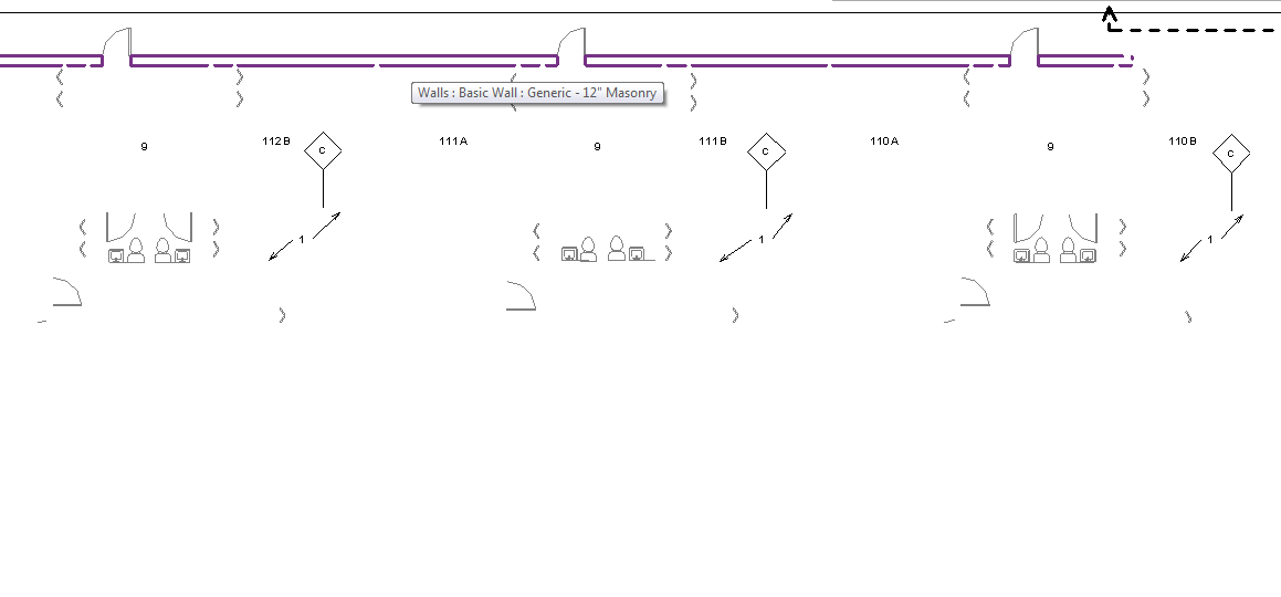

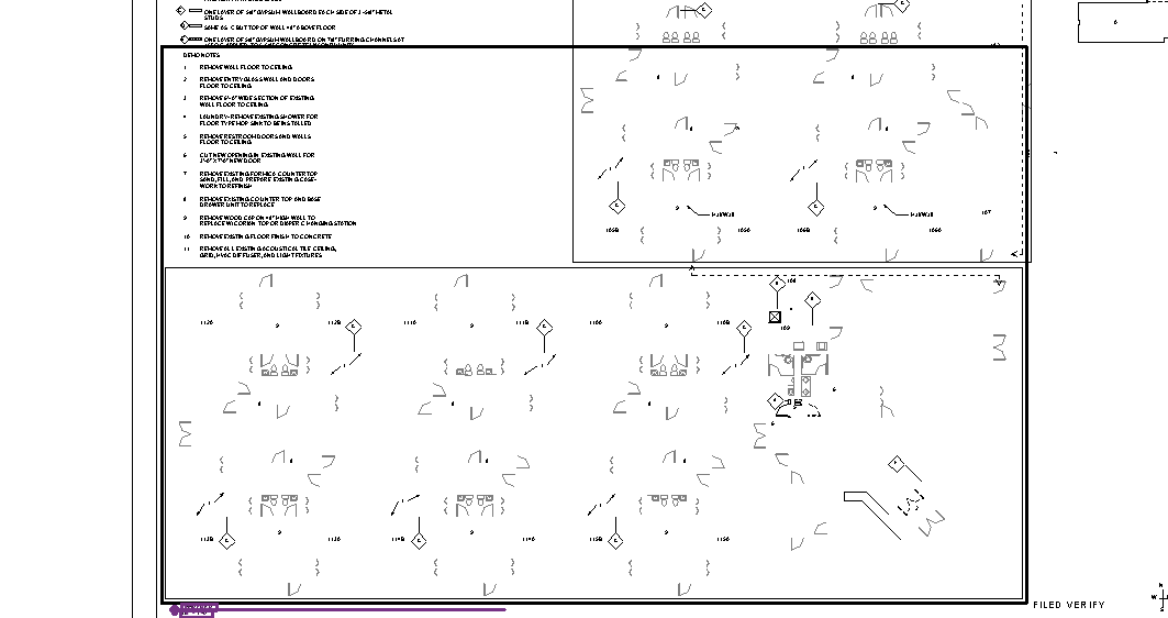

So we upgrade to Revit 2011 several months ago, and I opened a project that was orginially done in Revit 2009, but was modify in Revit 2010. When I opened the project up, there is one sheet were the walls wont show up. They did before in 2010 and 2009 when done. Ive checked to make sure walls are turned on, Ive not changed the phasing on it, but checked it an it seems ok. When i print or pdf the walls will show up, but its kinda difficult to work on the drawings with the walls dissappearing. Didnt know if anyone else was having this kinda issue or know of a fix.

Upgrading REVIT projects from one release to another is never recommended but some times it's inevitable.
2009 to 2010 to 2011 . . . . might be inviting trouble.
Personally, rather than spend the time to fix this (potentially unfixable) problem I'd just finish this project in the version of REVIT that works and get on with my day.
As a fix I would try a copy / paste the objects to a new empty project with a 2011 template.
BTW . . . . that's a pretty old project . . . . finish it already : )
Tue, Dec 21, 2010 at 10:11:42 AM | Walls Wont Show Up In View After Upgrading From 2010 To 2011
I have upgraded multiple releases without any significant changes.  Never seen your problem but here is the fix.  Make a new view - same type.  Copy paste all annotative elements between the old view and new one, then swap it out on the sheet.  Then delete the old views.  I would also audit the file afterwards.
