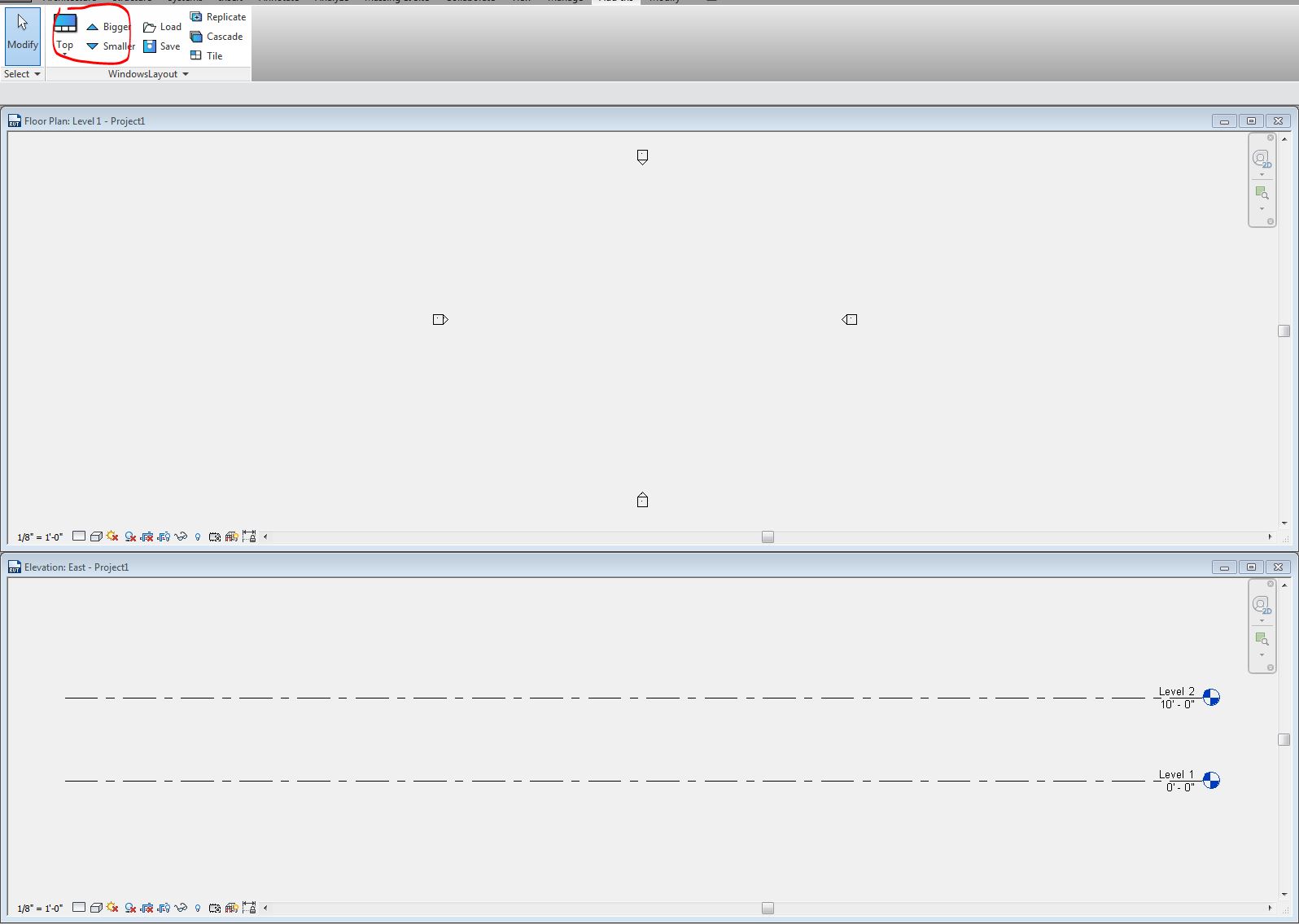

Mon, Sep 14, 2015 at 10:22:54 PM | Tile Window ... horizontally??
pijpiwo
pijpiwo Avatar
Joined: Fri, Sep 3, 2010
0 Posts
5 Stars: 25 Votes
There is a free add-in. Hit ‘top’ or ‘bottom’ layout and adjust the window size you want. It will remember the settings next time you press ‘top’ or ‘bottom’. Check other options as well – kinda neat.
