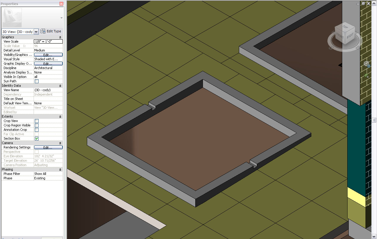

I'm using a a generic wall to create some site planters and for some reason on two sides Revit is taking the liberty of creating little notches in the top. I've tried moving out of the join and re-joining, raising and lowering, switching wall types, changing levels..no luck. Any thoughts?

Check to make sure you don't have an intersecting wall in that location on a different phase.  You could not be seeing it due to your phase filters.

Good thinking. It was actually one of my design options. Thanks!
