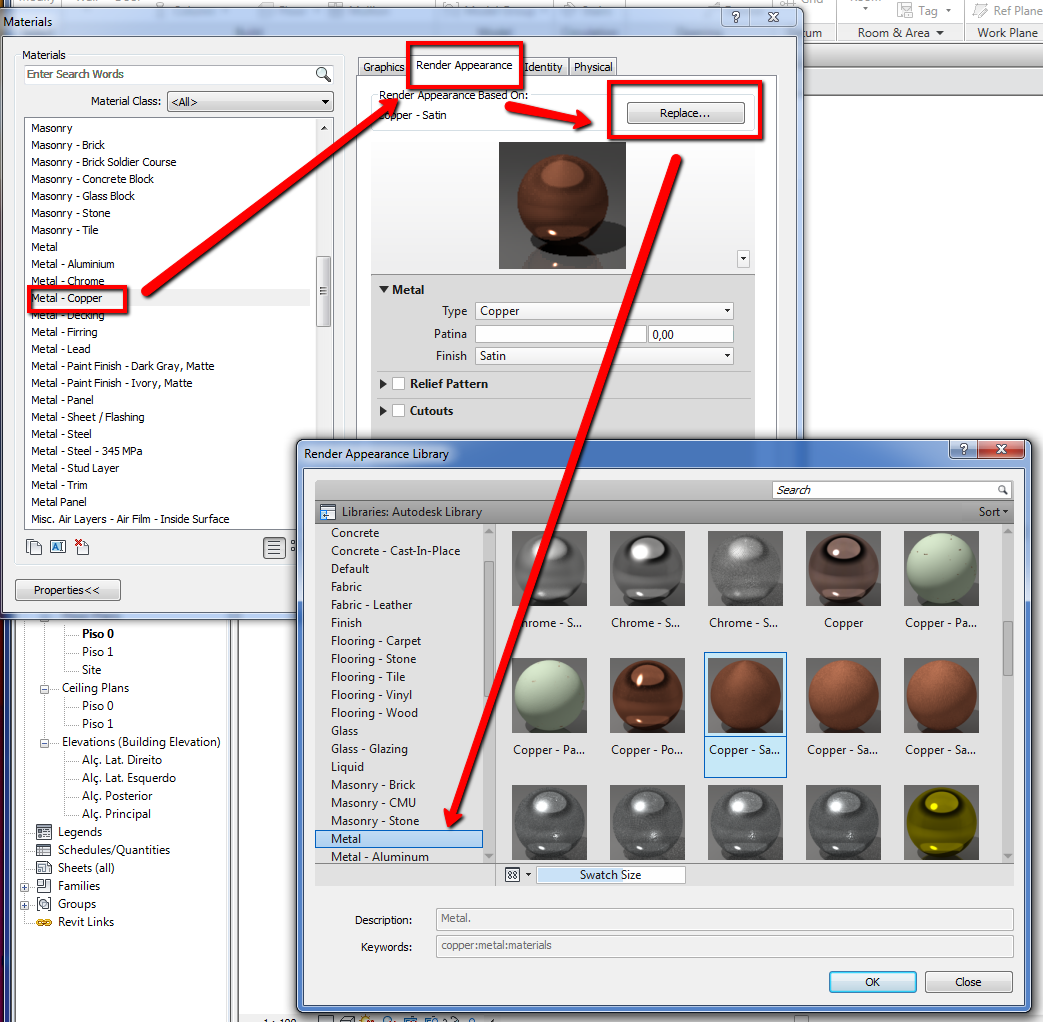

It's the same, Materials > duplicate > Render Appearence > select the material you want

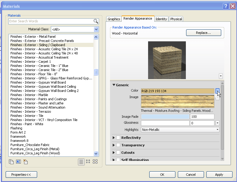

I am having a similar problem...I need to change the color of the the clapboard siding material, but no matter what I do, it remains the default white color.  The material is defined by the image "Thermal - Moisture.Roofing - Siding Panels.Wood.Horizontal.White.jpg", so does this mean that I have to manually edit the color of the image reference outside of Revit?  If it is possible to edit the color of this material within Revit, that would be the preferred method...please help!

Thank you for the quick response.  Unfortunately, it looks like wood siding is one of those fixed jpeg materials.  Any suggestions where to obtain an add-on material library?

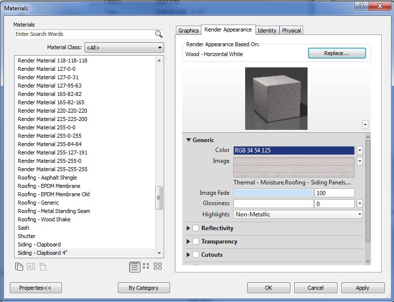

See the attached screen shot.  I'm using the horizontal wood siding material, but even when I change the color, the preview of the rendering does not change to reflect the adjusted color.  I think this is happening because the material is referencing a jpeg image for texture.  Regardless, I need to be able to quickly change the siding color to a custom color, not the grey, white or beige colors that Revit provides.

I'm sorry - I was mistaken.  It has been awhile since I had to do some of this and things change when we switched from the accu-render engine.  The color adjustment is only for solid colors and will not alter jpg images.  You would have to alter the image file.
Sorry to miss-lead you.
