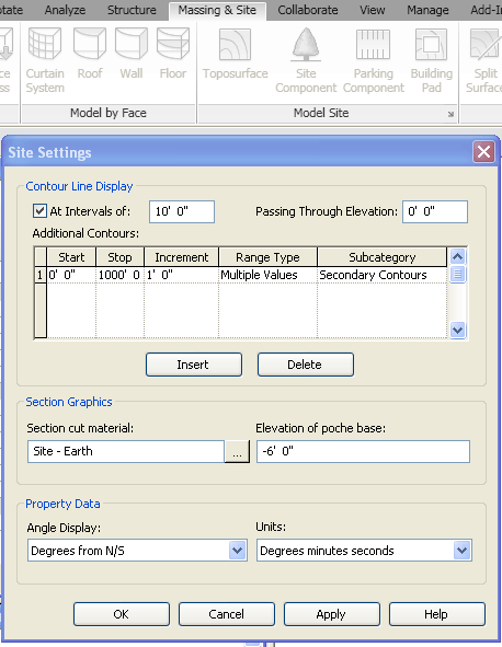

Is there a way to add thickness to a toposurface so that when it is cut in section it looks like thick poche? The sections are only cutting a plane of the surface and not showing me the 'mass' of the site itself. Thanks.

In your site settings you can control the poche material, and its extent. This way in section revit will show a cut pattern to the set depth...

Mr. Spot, you mention the thickness can be set in Site Settings - where might they be found?
Tue, Jan 24, 2012 at 9:46:42 AM | Toposurface thickness?
Massing and site tab.  Elevation of poche base.

Thanks, I found it by searching the online help.  Autodesk made the settings button a bit too subtle in my book.  Perhaps I'll remember to lookfor the little arrow in corner from now on.
