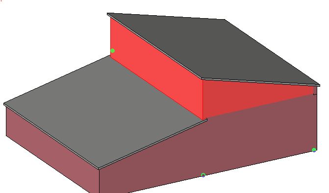

I am using Revit 2011 architecture. I have created all external walls of a building, the roof that covers the building is in two sections both of which are at different levels. The wall that makes up the different in level is taken off a beam and is the same construction as all external walls. The front and rear wall intersect with both the high and low section of the roof and i have connected it to the roof and this has formed a step in the wall as needed. My problem is the wall that makes up the difference in level i.e. running front to back will not wrap with the front and rear walls and leaves a very ugly grey area at both intersections. Help!!

Split the walls in a section so that the wall that bridges between the roofs and the incoming wall that doesn't joint up properly are like the red ones in the attachment (ie they are on another level to the lower walls), trim the bridging wall to the front to back walls & it should be correct. If there's a funny line between walls on 1st & 2nd level use Join Geometry tool
