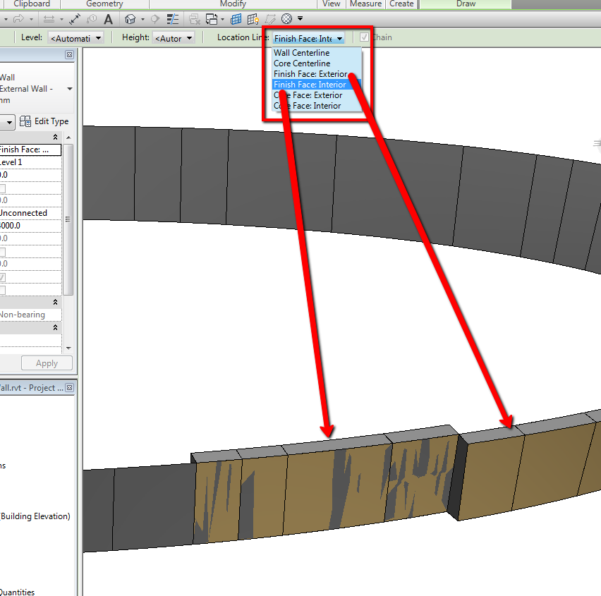

Tue, Dec 14, 2010 at 12:51:04 PM | Complex External Wall Modeling - Urgent Help Needed
Joined: Tue, May 22, 2007
5921 Posts
4 Stars: 205 Votes
This is clear for you?
Wed, Dec 15, 2010 at 3:48:59 AM | Complex External Wall Modeling - Urgent Help Needed
SteveHole
Joined: Fri, Apr 23, 2010
5 Posts
Sorry, probably di not make my self clear, if you changeposition of the wall as indicate, when you look at the wall on plan the build up is backwards, ie the internal finish is on the outside of the wall... Any ideas how to swap it around?
Stephen Hole
Associate - Michael Cook Associates
Stephen Hole
Wed, Dec 15, 2010 at 7:43:59 AM | Complex External Wall Modeling - Urgent Help Needed
You did not read Typhoons answer correectly.  A wall has a flip switch (which side is in or out) and a wall has a location property.  Typhoon is showing you that you need to change the lacation property when you place the wall.  The wall's location can be based on inside face / outside face / centerline of wall / center of core ... understand?  You assign how the wall is placed in that manner.

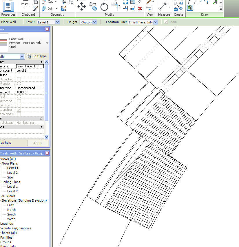

Wed, Dec 15, 2010 at 8:56:31 AM | Complex External Wall Modeling - Urgent Help Needed
SteveHole
5 Posts
Yep... Fully understand that, but it's putting the wall construciton the wrong way round.When I select external face, the external face of the wall build up is against the mass. When I select internal face, it does move the wall inside as shown on Typhoon's post, but the internal face is against the mass. Hence the wall build up is backwards, see attached picture...

Wed, Dec 15, 2010 at 10:21:52 AM | Complex External Wall Modeling - Urgent Help Needed
lunchtrayrider
Joined: Sun, Jun 24, 2007
592 Posts
3.5 Stars: 7 Votes
so you maybe built the wall backwards in the type editor?

Wed, Dec 15, 2010 at 10:58:06 AM | Complex External Wall Modeling - Urgent Help Needed
#9
Space
Joined: Thu, Jan 15, 2009
8 Posts
I think Steve is saying the location line of the wall isnt the issue, its the way around that Revit is applying the face.
The location line just defines where the wall is located from the mass face (inner-centre-outer) not the actual facing of the wall (facing inwards - facing outwards).  You do not get a 'flip' switch on a wall created from a mass face when the wall is curved (you do for straight/flat).
Revit will always put the external face of the wall facing outwards, however because your mass is not a solid mass (just face's) Revit has interperated the inside face of the mass as the main face which is incorect for your situation.
The solutuion is to remake the mass as a solid, then when you apply the wall, it should function as expected. I would also clean the mass up a little, its currently very segmented.

Wed, Dec 22, 2010 at 10:15:59 AM | Space
#10
SteveHole
5 Posts
Sorry for the delay in getting back, been unwell...
Converted the mesh to a solid form and that works fine... Thanks for the help...
