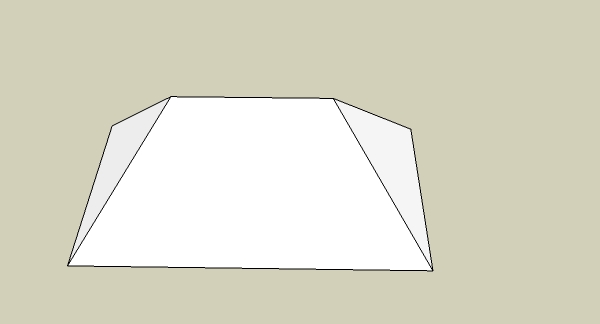

I would like to know how to do the ramp like this in Revit?See attached image.

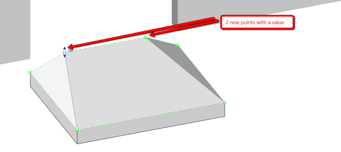

create your floor and finish sketch.
select your floor and choose "Modify sub element" now add 2 more points to your slab and give them whatever value you need. see attached image
