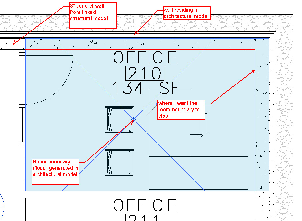

When identifiying a room (boundary) how do I get revit to acknowledge an exterior wall (structural) that was generated from a linked structural model?  see attached
thanks,
Boyd

You could draw a "Room Seperation Line" That would sort it.

Search help using "ROOM" and you will find this topic: Room Boundaries in Linked Models Read that and it will answer your question.
