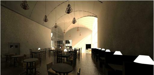

I can't seem to get the wood floors in Revit to actually look like wood floors when they render. They're just so incredibly shiny, how can I get the wood grain to show?
Enclosed is the best image I've been able to come up with. You can somewhat start to see that the floor is wood, but I'm looking for something much more obvious. The glare is too much.

Increase the Quality and Resolution (DPI's), it will take more time to render but...

Tried that. The attached image is a lower quality save for uploading purposes but it rendered for a good hour and a half to get that. I can't make the quality very much better...

Are you render in High, Best quality? 300, 600 DPI's?

Drop the reflectivity on your material?

You may want to go to the material settings and check there. You can change it from shiny to matte or even unfinished and that will drop the reflectivity.
