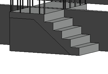

I am setting up a entry stair. The stairs need solid space as the pic shown. But the only way I knew is "component-model in place" and there is a clear line between stair and that component. "Join" commend is unavailable to the effect here. Does anyone know better way than adding component?

Thats the best way I know how. The line can be removed from a view with the linework tool.

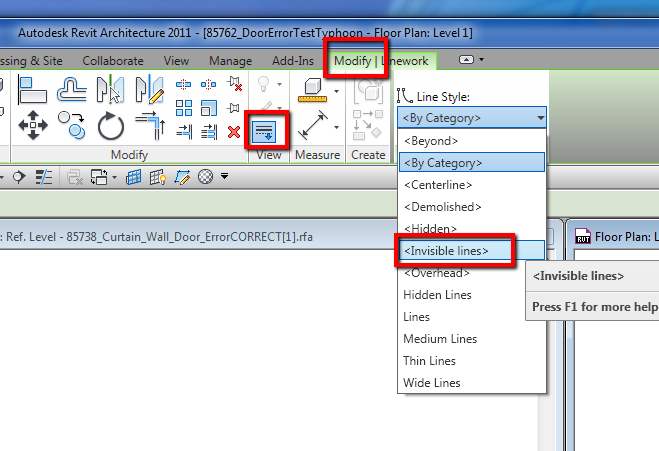

You can create a "Wall" (instead of in-place)  then edit the wall with that shape, to "Clear" that line use the "Linework" tool "Invisible line"
