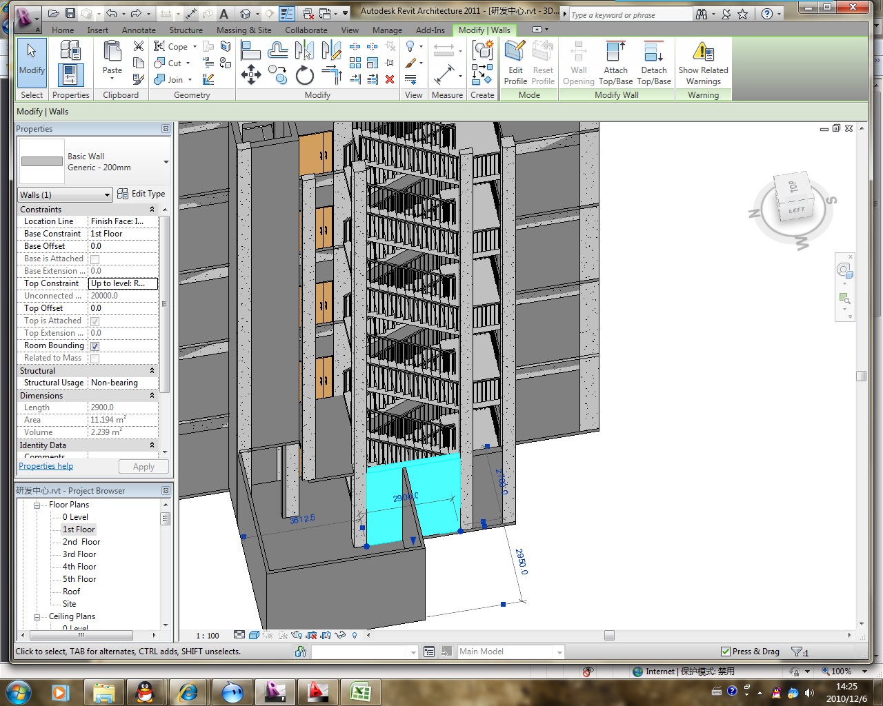

Hi, guys,
see my the attach.
I was asked to set it the wall from 1st to top. I drew it in the plan view,  but it doesn't work even I change the property. However, it does work when setting 1 to roof before drawing the wall.
I just wonder is it a bug?

If I am understanding your question right, your problem is that your wall is attached (likely to the floor above).
Select the wall and then select 'detach' and finally click the little 'detach all' box.  It will then revert to the settings in your element properties.
 Attached items are constrained by the attachment and that overides any numbers you put into the element props.  You must detach first in this instance.  This happens if you build a floor and say yes to 'do you want walls that go to its bottom to attach'

I second what rudyard said. Your wall is attached.

Thank you. I have fixed itSmile
