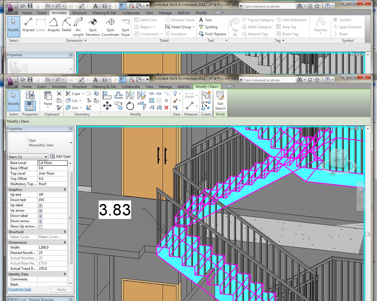

Hello,
I have big problem on stair settings.

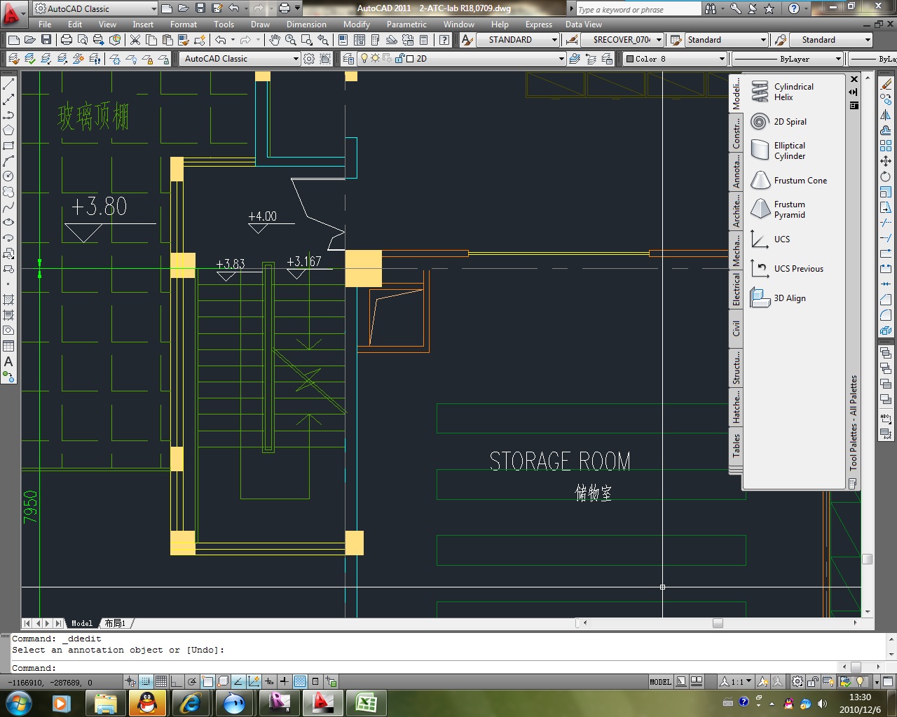

1 story=4 meters. The elevation of stairs in AUTOCAD is shown in the first screen of 2nd floor. Stair numbers contains 24 including the last step to story floor. But in the revit, when I set level (1st, 2nd), riser heght 166.7,it's shown  23 numbers instead, and the last step shows 4 meters as story floor.
Could any one tell me how to set the parameters? I need the model shown exact elevation like autocad, the plan is as same as autocad though.

change the formula inside the revit stair type. 2 riser+1 step= x. You need to change the X. And adjust the start with riser/end with riser.
