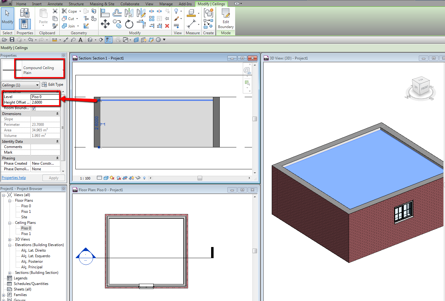

I am working in Revit Architecture 2011 and I can't see my rcp. My lights show up in Level 2 of the floor plan. I can't place any lights in the rcp, only level two of the floor plan, even though there's ceilings!
Why?!
Sat, Dec 4, 2010 at 5:17:17 AM | Reflected Ceiling Not Showing
Joined: Tue, May 22, 2007
5921 Posts
4 Stars: 205 Votes
Place your ceiling in "Ceiling Plans", create a section view or a 3D view and there you can control the height of that ceiling.
