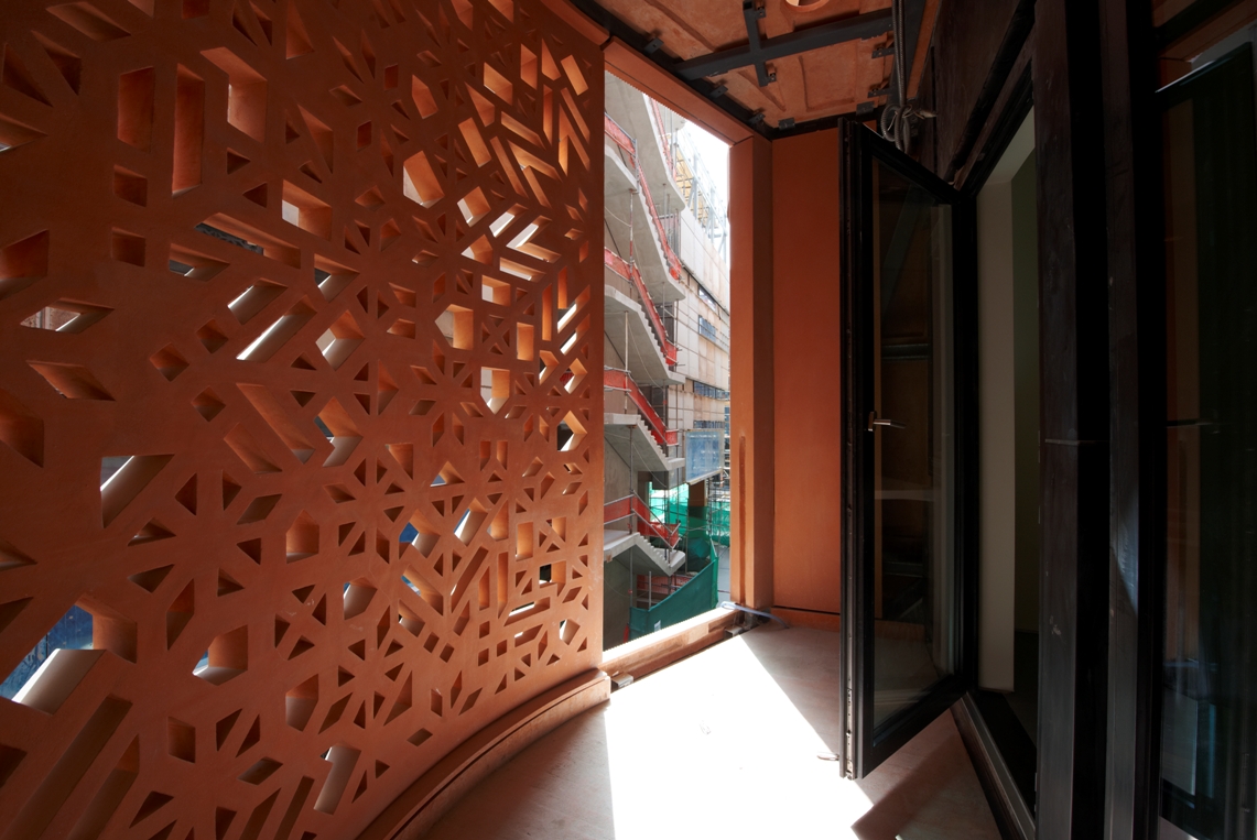

but I cant figure out how to make what i want . something like the image attached. it will be basicaly wood blank window and then I want to cut triangular shapes off.. when i created mass I could work on vertical way too. in families I cant even figure out how to copy the work plane:S
please can someone explain to me?

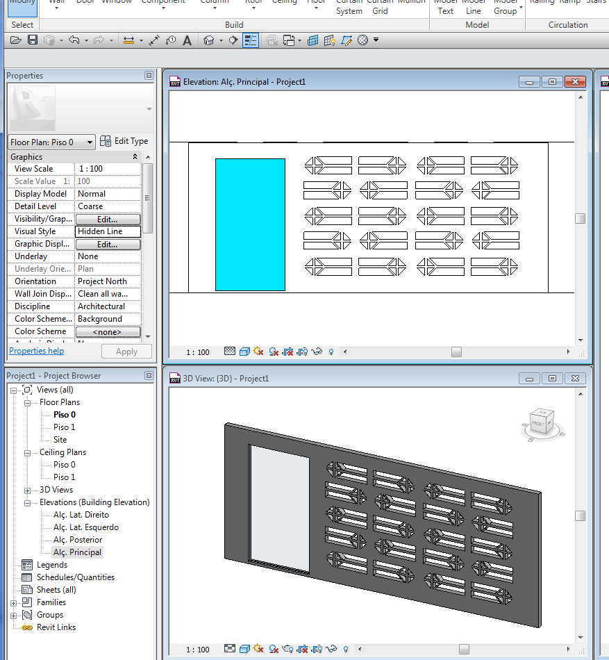

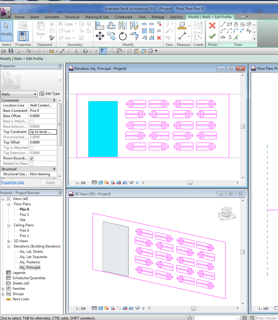

If the wall is flat just "Edit profile" that wall and draw the shapes you want like you can see in the images attached and create a "Automaticaly Embed" curtain wall , if the wall is in curve you must use a "In-place" family (VOID) in the category wall to create that effect.

thanks typhoon!
also this video helped alot  http://www.youtube.com/watch?v=TDWxRgC_oA0
its easier to choose wall based family and change parameters to window than do it with window family
