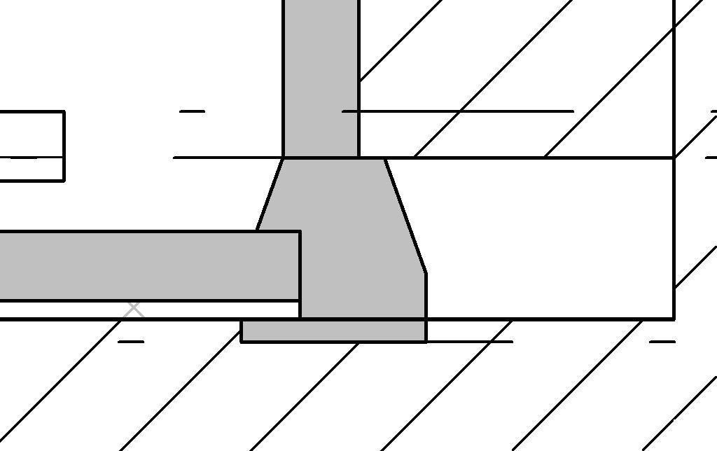

When we join the foundation ( which is an wall extrusion/sweep Winking with the floor, Revit always cuts the floor out of the foundation.
We want the foundation to have priority instead of the floor.
How can we manage this ?
Fri, Dec 3, 2010 at 2:41:37 PM | Wall extrusion and floor join not right
Revit considers it to be a wall.  You should try something else.  Perhaps an in-place family sweep - category foundation.
