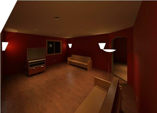

Just getting started with rendering in Revit. I used Revit Architecture 2011 to create this image. I'm getting some funky pixelation from the lights reflecting on the floor instead of a good solid light reflection. Any idea what's causing this? Check out the attachment to see what I mean.

Typically that pixelation is caused by lower render settings. You may change the reflectivity of the flooring and it may go away.

Thanks I'll give that a try
