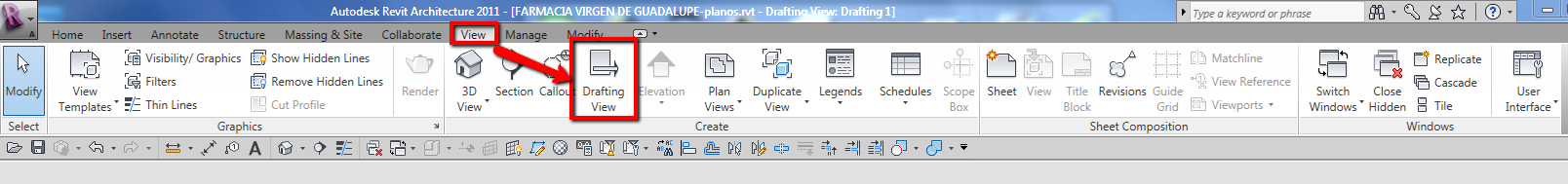

Is there a way to import a google map view into a Revit view?

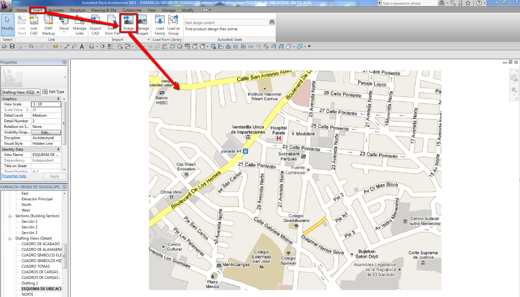

I've seen it inserted as a .jpg, I assume that it was either a screencap or GE may have a tool for exporting as a .jpg. I don't know of any other way to do it, but I haven't really researched it.

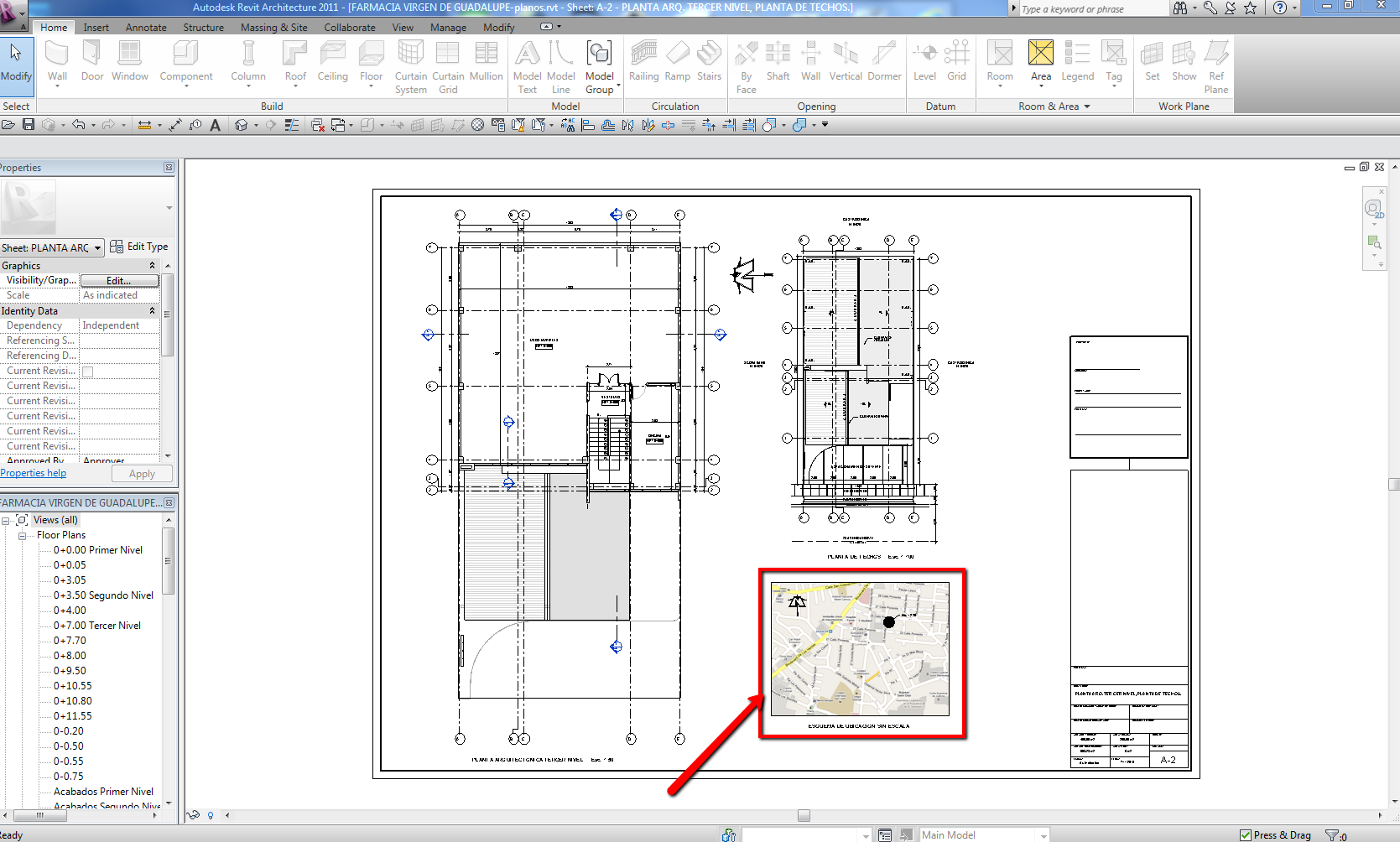

Just create a drafting view and then insert your Google map there or insert it directly on a sheet......
