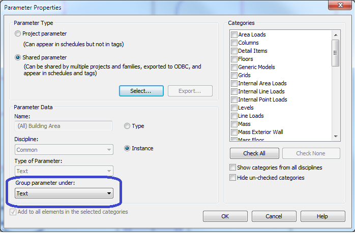

When I go to add a shared parameter it allows me to select the shared parameter from the typical shared parameter file then in the "Parameter Properties" box there is a "Group parameter under:" that I am able to select...is there a way to add to that list?

Right, but what I am trying to do is change the group in which the parameter is listed under in the properties box.  I can make multiple groups for my shared parameters but when it comes time to associate them with an item I would like to customize the headings in the properties box which comes from "Group parameter under"  I made a new Shared Parameter group but I am not seeing the connection to the "Group parameter under" in the Parameter Properties

Let me try again...and thank you so far for your assistance.  My process of making a new shared parameter is this---
  1. Shared Parameters
  2. Make new Group (Rebar) or Select Existing group to add the shared parameter under
  3. Make the new Shared Parameter "CryingSlab) Slab Face"
Adding this new shared parameter to project
  1. Project Parameter
  2. Add
  3. Check Shared Parameter and Select the parameter I just made
  4. Revit Automaticlly fills in "Name", "Discipline", and "Type of Paramater" for Shared Parameters
  5. I select the categorie(s) I want this parameter to go under
  6. But now I have a pull down called "Group Parameter Under:" (unrelated to the "Group" that the shared pararameter is under in Shared Parameters) that puts the parameter under this heading in the Parameter Box of the element when working...I would like to add a new field to this called "Slab" or "F&F" or "Beam" etc is this possible to do and how can I do it?

Well gee... why didn't you ask that from the beginning?
NO... can't add to this system level list.
