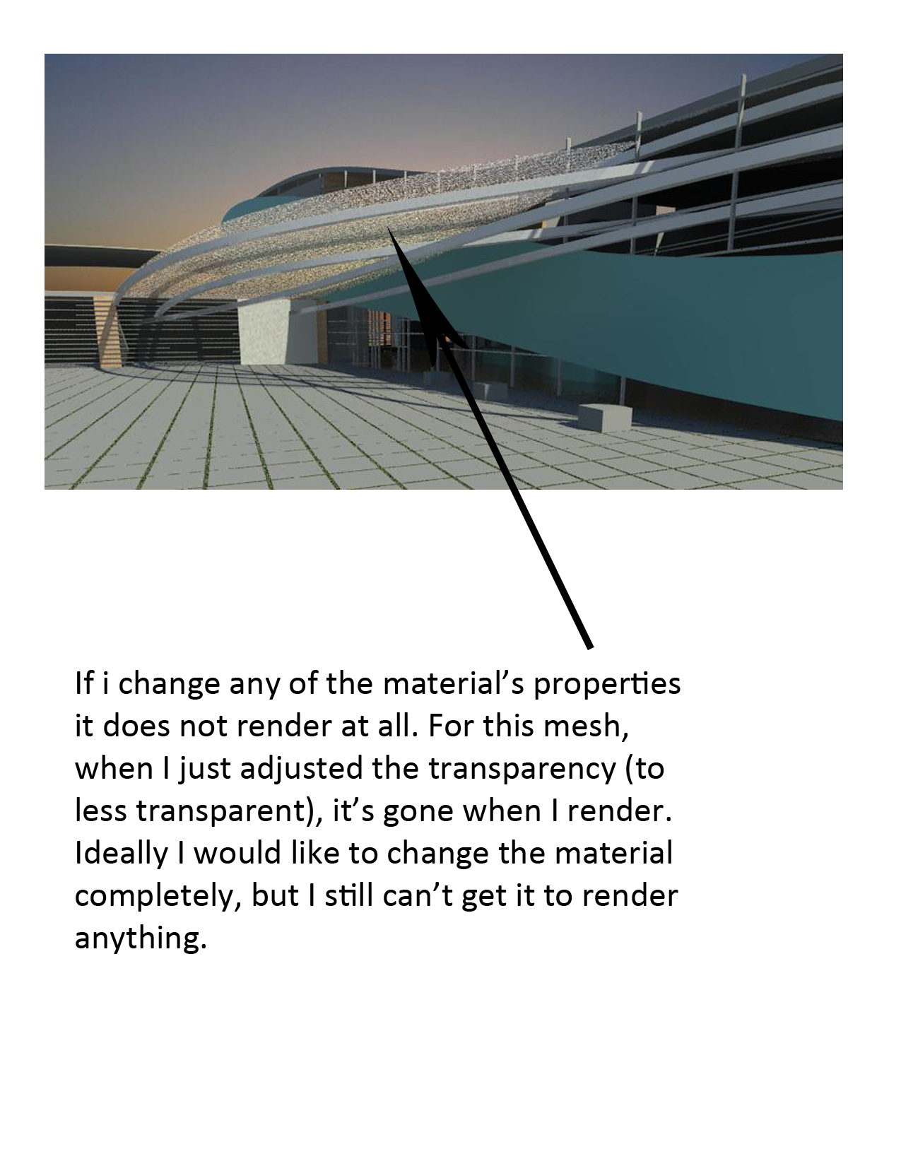

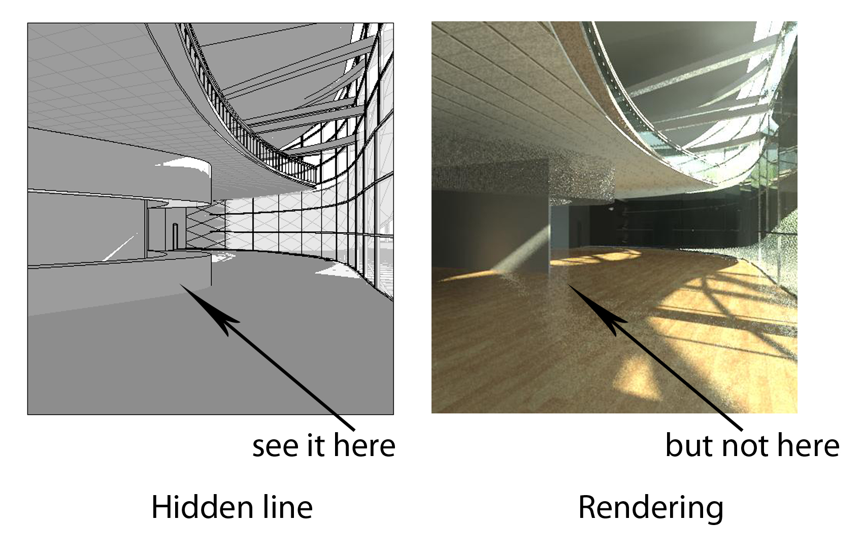

tallon314, i am having the same problem! im using revit 2011 and when i change the materials of certain objects, the objects either render gray or the item is gone completely in rendering! it is so frustrating and i have a final project due. i attached an image of what is happening. it is doing this in multiple places in my project.
i feel like i have tried everything but still can't get it to work... did you figure out how to solve this problem???

What material did you assign to that element? Can you show us some images with the properties/materials of that element? did you install the Web update?

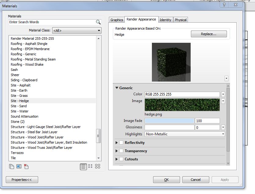

Here is one of the materials giving me issues. I wanted to use hedge instead of grass, so i duplicated the grass material, renamed it, then replaced the image for rendering to hedge. The file is in the correct location and not missing.  But when i render the object is gone entirely. Here is a shot of the material properties.
I did not get the web update for 2011, but i just got 2011 about 2 months ago from autodesk students. Do i even need the update or is that for earlier versions?

hle3 - Was your post the answer to Typhoon?  - You assigned hedge to the counter?
What you posted is indeed hedge and it is assigned to hedge.  So what is the problem with this?  So us where you assigned this to the counter if that is what you did.

Thank you for all of the responses. I too am using revit 20111 on windows 7 x64, and I think is the same error with that and I can probably just render on a different computer to fix it. Sorry for the many questions. The images were of different instances in my project that were not rendering. The hedge was in a different place than the counter, but was having the same problem.
